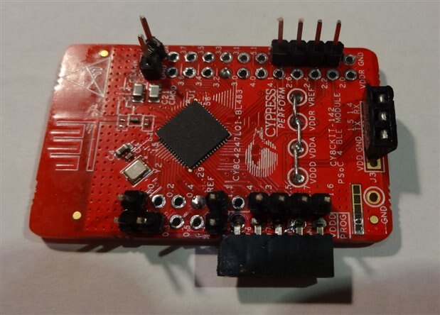

Before soldering the ADXL on a Perfboard, I prepared the PSoC BLE module board. I had already removed the existing female headers, and now added male headers for the pins that are needed:
The two female headers are for the Miniprog3 and the serial debugging output.
Cypress did the same mistake as Analog Devices - using non-standard pin layouts. Both headers rows are not spaced in a 100mil grid (the headers itself are, but their distances isn't). So I needed to solder in the pins sideways to fit the perf boards in top. Same is true for the supply pins (Vddd, Vdda, Vddr). Why do manufacturers do this?
