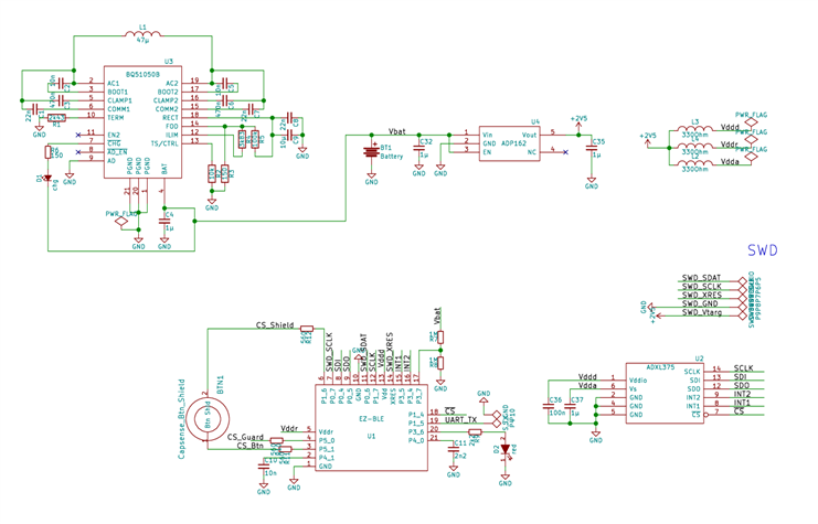

So my final schematic looks like this:

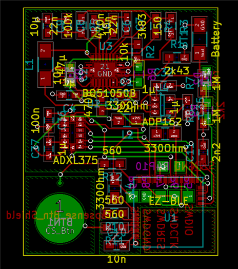

Its less crowded than the last version since all the support circuitry around the PSoC4 BLE is now in the EZ-BLE module. My current PCB size is only 28x35mm which nicely fits the coil and the battery I'm using:

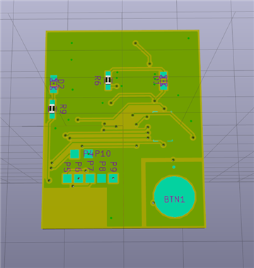

In the bottom left there is a CapSense button which is, together with the two LEDS, the only user interface elements thats needed. In 3D rendering this side is only sparsely populated:
In the bottom left there is a free area, which ensures that the antenna of the EZ-BLE on the other side is not disturbed. The pads above that are a programming header (5-pin MiniProg3) and for a UART debugging output. In a final version they could be removed.
The board layout and routing is probably not optimal, but I wanted to have as less components of the front side as possible since it acts as user interface.
Since the pitch of the EZ-BLE module is 0.76mm it should be better so handle than the ADXL chips with its LGA package. All passives are 0603. This is small, hand-soldering will be difficult but doable.
So in its final form SkiMon will be about 30x35mm and 10mm think (4mm for the battery, 2mm for the coil, 1.6mm for the PCB, 1.6mm for the EZ-BLE module as the thickest component and 1mm for the LEDs. There would be no special case needed, it can be potted completely in clear resin.

    Sorry about that. Element14 had an outage while I was writing this entry, so I left my computer on and quickly hit "publish" this morning just before leaving for work. Seems the picturte was not uploaded - I added it now.

    hey, I think there is a third image skimon_small_front.png - right?
    I can't view the image!!!!
