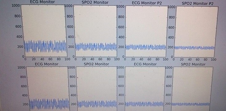

Currently a small application is ready for testing the ECG and other data. The application is running on Raspberry pi which is receiving the data wirelessly using Bluetooth low power module. This application will be used for initial testing and implementation. The application is built on python tkinter.
Figure 1: Application running on Raspberry Pi

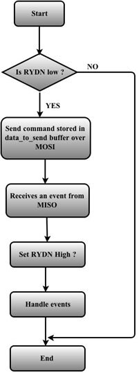

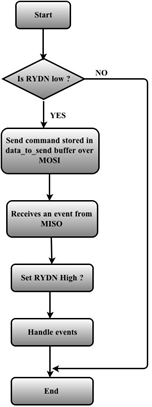

The data exchange between ADuCM350 and nRF8001 has been split into two types: command and event. Command is a data exchange which will be initiated by ADuCM350 microcontroller and transmitted to nRF8001, while event will be the data exchanged in the opposite direction.
Firstly, ADuCM350 sends a request of sending a command to nRF8001 by setting REQN low. Next, nRF8001 responses the microcontroller by setting RDYN low when it is ready to receive the command. Then ADuCM350 starts to transmit this command over the MOSI pin (shown in Fig.3)
On the other hand, the event is initialized by nRF8001 setting RDYN low. Then ADuCM350 informs nRF8001 that it is ready to receive events by setting REQN low. The event is exchanged over the MISO pin.
Figure 3 : Flowchart of SPI Communication
