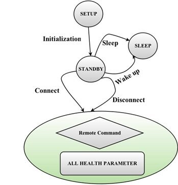

The application layer module defines different health parameters. The system operates in four modes: setup, standby, active and sleep. Fig 4 shows the state transition between four operational modes.
When the power is on, the system will be in the setup mode. After initialization, it is transferred to the standby mode. Then, the Bluetooth low energy radio starts advertising and will make a connection with a smart phone. Once it successfully establishes connection, the system enters the active mode. In the active mode, a smart phone will be able to control the ECG device by sending a remote command. According to the received remote command from a smart phone, the device starts to sense vital health parameters and will transmit them via the Bluetooth link to the smart phone. When the connection between the smart phone and the wearable device is lost, the system enters the sleep mode in order to save power.
Figure 4 : State transaction between four operational mode
