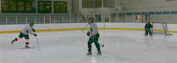

Since I play hockey every week all year, I expect to mount the Crown Tools  on my hockey helmet and view results on my smart phone. I certainly would not be looking to bang my head, but I can capture some video of the device in a hockey game and separately show video of the helmet and sensor sustaining impacts without a real head involved and of course show the resulting impact information.
The Heart Reactor will be easy to video on my exercise bike.

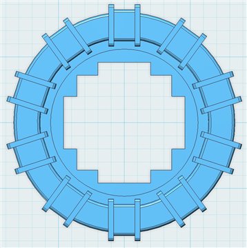

Update 2 - Heart Reactor System Design & Mechanical Drawings
The project kit has not arrived, but the design continues to take form.
Some extra materials have been ordered, including plastic filament, Bluetooth modules, LEDs, Qi wireless charging transmitter and receiver, BGA reflow nozzle, EKG electrodes and cables. Also compiling a list of materials to order from E14 such as extra sensors, MCUs, LED drivers and 3D printing supplies.
The Heart Reactor packaging design is progressing despite not having a 3D printer yet.

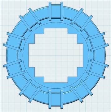

In addition to displaying a numerical heart rate, I expect to be able to pulse the reactor LEDs in synch with the heart beat.

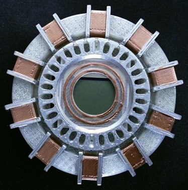

Here are a couple of 3D components - the glow ring and the display turret - as they stand now:
Update 3 - 3D printing tests and preliminary electronics design
The translucent PLA has come in so I have been able to print the reactor ring and display turret. Here is a picture demonstrating how the material transmits and diffuses light, although the final light source will be more concentrated in the outer ring and some of the features will be coated with metallic paint. The 3D printing process is shown in more detail in my 3D printing road test here:

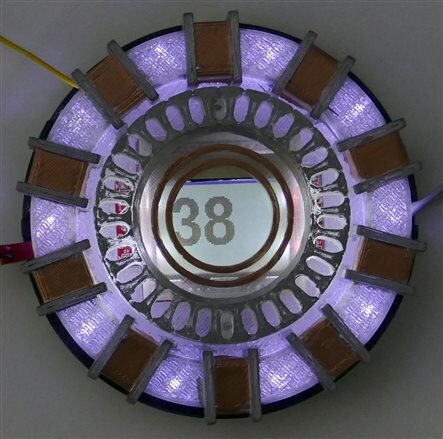

Update 4 - Heart Reactor preliminary 3D printed parts and painting
Proceeding with what I can without the project kit, here is a picture of the Heart Reactor with copper and silver added:
The next step will be an inner bezel. Also although I have ordered some materials and components from third parties, the order with e14 is still being finalized as the design solidifies.

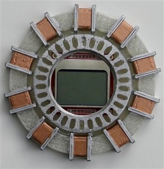

Update 5 - Heart Reactor 3D printed parts with inner bezel
Here is a picture of the Heart Reactor with inner bezel:

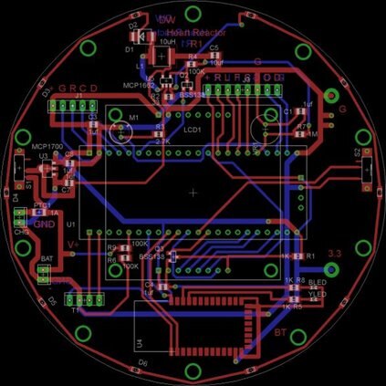

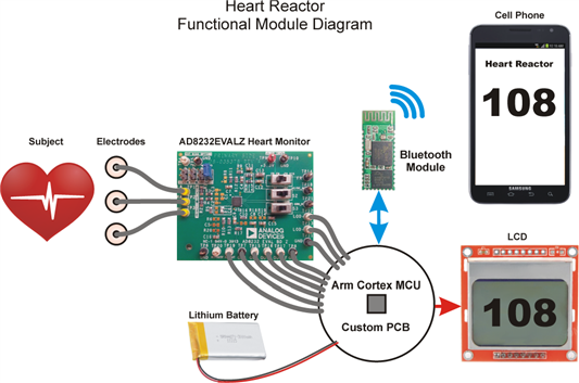

Update 6 - Heart Reactor electronic design and PCB layout
The heart Reactor schematic and PCB layout have been designed using an ARM Cortex M0 MCU module, but I need to confirm the hardware pinout configuration will compile before I have the PCB fabricated. The MCU is one I have in stock since the project kit has not arrived yet and the Analog Devices MCU module looks too big to fit in this form factor - and the project is just too big and the risks of failure are too large and the time is already too short to wait for things to arrive before starting detailed design.
I will post an update to the layout image if the layout needs to change based on compiler issues.
Note the circular PCB has 10 LEDs around its circumference to illuminate the outer ring of the reactor. This module interfaces to the Analog Devices heart rate monitor module and temperature sensor module as well as an LCD.

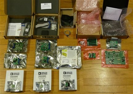

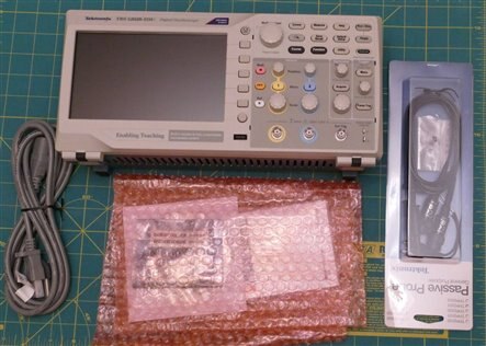

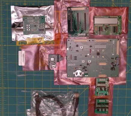

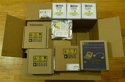

Update 10 - Unboxing the Project Kit
The massive kit of parts and instrumentation just arrived from element14, Analog Devices and Tektronix. Here are some pictures of the unboxing...
Note the Tektronix oscilloscope hiding underneath.
This is only some of the modules from Analog Devices...
These are some of the modules associated with the ADUCM350 CPU.
This is the Tektronix oscilloscope that was part of the kit - wow.
Now it is time to get busy and figure out how to use all this stuff.....

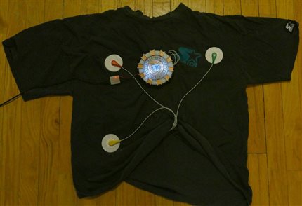

Update 11 - Preliminary documentation and first test of the heartbeat sensor
I have been working more on my impact paper that explains the issues and approach to capturing useful impact data.

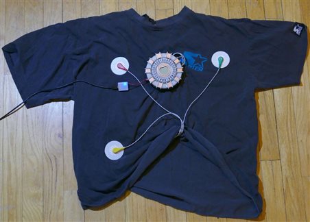

Now that the Analog Devices kit has arrived, I can show the heart rate module they supplied connected to the Tektronix oscilloscope that also came with the kit.
I don't know where the best locations are to place electrodes, but I am using three electrodes - right arm (RA), left arm (LA) and right leg (RL) connected as shown here:
It is very useful to look at the analog signal to try to figure out how to process the data  to obtain an accurate heart rate. Clearly there is a lot of EMG (electromyography) signal as I move around because all muscles generate electrical signals when exercised. This will need to be ignored when trying to detect heart pulse signals.
Here is a video of my first connection of the heart monitor circuit:

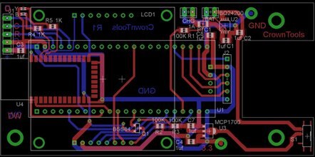

Update 12 - design of the Crown Tools circuit and PCB layout
The second microcontroller schematic and PCB (for the Crown Tools impact system) have now been designed - I will give it a final check tomorrow before fabricating. This card will use the Analog Devices ADXL377 tri-axis accelerometer.
The other PCB (for the Heart Reactor) should arrive in the next few days so I can start soldering components and testing the circuitry.

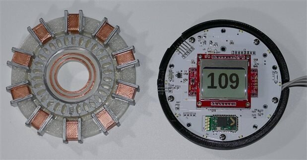

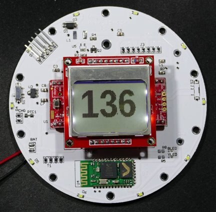

Update 13 - Assembly of the Heart Reactor circuit card and initial circuit tests of the CCA (circuit card assembly)
The Heart Reactor PCB has been fabricated with a white solder mask to enhance LED reflections. I have assembled pretty much the entire circuit card assembly except for the out ring LED driver which has not arrived yet. The LEDs are soldered and they work - just missing one driver chip. The circuit checks out well so far - powered up with no smoke. Here is a picture of the circuit card as it stands now.
Notes: - the CPU is under the display to save space:
- the bluetooth module is visible below the display
- the unpopulated connector above the right side of the display is for the heartbeat sensor which will be located underneath the circular card
Here is a short video showing the circuit board in operation.
Here is a short video showing the Heart Reactor counting on the display, similar to the breadboard video in update 10.
The next step is to see if I can get the Bluetooth module working.
Then I will try connecting the heartbeat sensor and writing software to calculate heart rate.

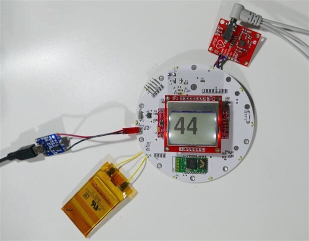

Update 15 - First fully functional Heart Reactor heart rate system tests
The last milestone was big, but this one is huge. I have the complete hardware and software Heart Reactor system working. After studying some EKG signals on my oscilloscope I figured out a relatively simple algorithm to robustly detect heartbeats from all the "noise" on the signal. My first attempt at a heartbeat detection algorithm worked great. I'm pretty used to my circuit boards working first time (not because I am any kind of infallible designer - it is simply because I cannot afford re-spin mistakes and I design accordingly), but I never expected the software to go that smooth. And inevitably it didn't. After I decided to clean up my original code and add a few features and make it a little more robust, suddenly it didn't work and the resulting painstaking troubleshooting took about 8 times longer than the original code. I was wearing electrodes the whole time which is not the most pleasant development scenario, but the electrodes don't stick well if re-applied and I don't have enough electrodes to replace them on every trial - that would have taken scores of electrodes. I switched from the Analog Devices evaluation card to a much smaller card with the same AD8232 chip on it. The signal wasn't quite as good, but that may have been due to my electrode arrangement; however the new card is much smaller and it has a 4 pin audio jack to make connection to the electrodes easier.
I also added a bit of functionality to the Bluetooth software although this video doesn't show Bluetooth operation.
There is still quite a bit of fiddly work to complete the packaging and connect the battery, but that should be pretty low risk.
I may have time to tackle the android app before the Crown Tools PCB arrives. It is going to have to go pretty smoothly from here on to get through both development projects before the deadline.

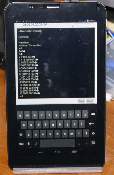

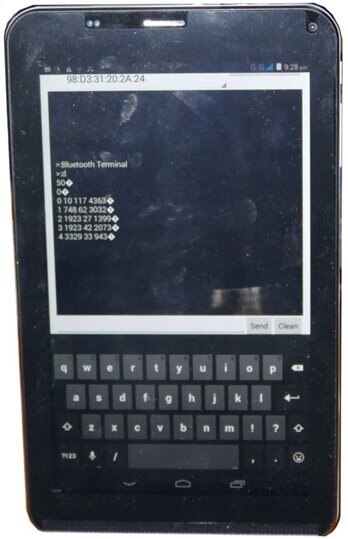

Update 16 - Android app tests of the Heart Reactor android app
This update is my first one showing my Heart Reactor android app. I figured I better document the fact that it is working before I clean things up because changes have a nasty habit of making things worse before they get better. (maybe it is just my programming style. ... or lack thereof) The app is programmed in MIT's App Inventor. All the code "blocks" fit on one screen - there are only about 30 blocks which would translate into about 19 lines of code - so It is pretty high level programming - a lot going on behind the scenes. The main issue is understanding the App Inventor block connectivity paradigm. I am moving around quite a bit during the video and you can see that my raw heartbeat detection algorithm occasionally cannot distinguish erroneous signals from heart signals. There are still lots of techniques I can apply to clean up the errors, but one step at a time....
This weekend involved a big push to get the Heart Reactor system working so I can start focusing more on the Crown Tools - from Friday to Tuesday I spent over 40 hours on it (and I still found time to play a baseball game on Sunday). Fortunately Monday was a holiday here and things went well enough to reach several key milestones, culminating in fully functional packaging, fully functional hardware, fully functional firmware and fully functional android app - basically full system functionality. There are still dozens of hours left to polish the system up, but it is all low risk activity.

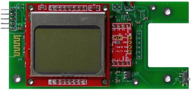

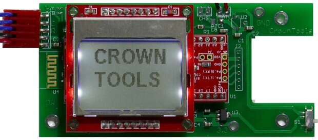

Update 20 - Crown Tools PCB Assembly
A large shipment of parts came in from element 14 today, so I can build up the Crown Tools PCB, but there are still a couple of chips missing.
Firmware development is now in full swing as the Crown Tools PCB is assembled enough to run firmware. The Bluetooth antenna is visible on the left and the red CPU module is visible on the right. Hopefully something will be running by the weekend.

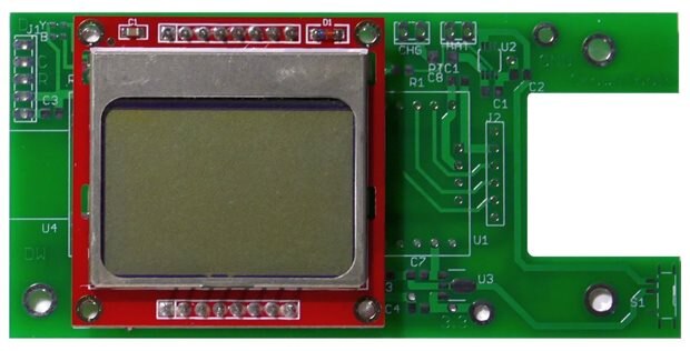

Update 21 - Crown Tools Display Working Under Program Control
Okay - first program running on the Crown Tools platform. Still much to be done, but another key milestone - validation of the Crown Tools circuit card.
Next I will print the base holder/adapter that mounts this card to a hockey helmet.

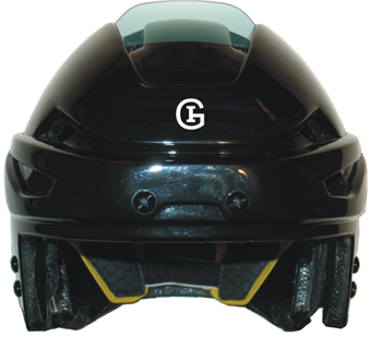

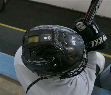

Update 28 - Crown Tools Mounted On a Helmet and Initial Drop Tests
In this update the Crown Tools has been mounted on a helmet and initial drop tests are under way.
The gluing job is pretty ugly, but black silicone is very difficult to work with in this type of application.
Note the inner helmet padding has been removed for these drop tests. The drop is arrested by a strong cable instead of an impact pad to prevent the helmet from bouncing off and rolling away.
In that last test, I should have said 95 m/s/s instead of 9.5 m/s/s.
So far the system is working quite well - no technical issues, just some issues getting the drop tests to be consistent.
Controlling the deceleration to accurately reflect a real impact scenario with this apparatus is problematic, but I mainly want to get the velocity to be roughly correct, and this arrangement allows the velocity to be independently calculated simply from measuring the drop height.
The Crown Tools design and build is now essentially complete - just tweaking firmware and calibration.
This test helmet doesn't actually fit me , so I will likely need to remount the Crown Tools on my normal helmet to try it in a game.
I'm not sure it is clear from the video, but the whole system is glued to black duct tape stuck on the helmet - hopefully It can be removed.

This video shows the Heart Reactor base design being rotated in 123D:
Here is what the Circuit card assembly looks like mounted in the base with the bezel removed over on the left:
Here is what the Heart Reactor looks like assembled - the black base is not very noticeable:
Update 30 - Reactor Ring LEDs
This is what the Heart Reactor outer ring of LEDs look like when illuminated.
In this picture they are running at a small fraction of their maximum brightness.

I transplanted the Crown Tools to my real hockey helmet for a test in an actual hockey game.
It recorded 11 events during the game with peak accelerations ranging from 2.2 g up to 4.8 g, which means the system is nicely sensitive to small impacts.
The 4.8 g events correspond to falling on the ice without hitting my helmet on the ice - more like whiplash than solid impact, but still anything over 3 g was a pretty good jolt.
Here is an image of the data as displayed on my android tablet back at my house after the game:
Note: I first connected to my Henrietta Project (GPS clock) before remembering which Bluetooth device was the Crown Tools.
The first column is the event number, the second number on each line is the elapsed time in seconds, the 3rd number is the peak acceleration (divide by 10 to get g's - I do this to avoid using decimal points) The last number on each line is the area under the acceleration curve - or equivalent drop velocity in mm/s if it is divided by 2.
The "0" event occurred 6 seconds after power up - I slapped the helmet before putting it on to check that it was recording properly.
This picture shows the Crown tools installed on my helmet and displaying the initial event. Note that the adhesive had not fully cured at game time so I added some black duct tape to make sure it stayed in place. I did not notice the extra weight of the Crown Tools once the helmet was on.

Here is a picture and short video of me warming up shooting at the net - hopefully it will help recognize me in subsequent videos:
Here is a short video of a scoring chance:
This is a clip of me losing my footing during a shot and going down - which created one of the 11 "events" during the game:
Incidentally we won the game 6-0 ( I got the game winning first goal and 2 assists).

Update 34 - Installation of Crown Tools
The curvature of the Crown Tools was designed to fit a particular helmet, but every helmet is different and I had to install it on two different helmets.
Originally I was going to use 3M VHB double-sided tape to hold the Crown Tools on a helmet, but this tape is very difficult to remove, so I ended up using black duct tape and silicone. First I covered the installation area with black duct tape stuck directly to the helmet so everything could be removed simply by peeling off the tape. Next I coated the underside of the Crown Tools with GE Silicone II (black) with enough silicone to fill in any gaps between the curvature of the Helmet and the curvature of the Crown Tools, plus I spread a thin layer of silicone on the duct tape. Then the Crown Tools was squeezed in place and the silicone was allowed to cure. Note that it is critical for the area under the accelerometer to have full silicone coverage. The silicone does not form a great bond with the duct tape, so I also tape the mounted device to the helmet. Also note the sticky side of the duct tape will not stick to silicone, so some of the tape should be stuck to the PLA plastic of the Crown Tools case.
Update 35 - Rigging the Heart Reactor
The Heart Reactor has mounting holes for metal "buttons" that would connect to a harness that has corresponding button holes. I bought the metal buttons and then decided it would take less space to use a string harness on the back of the Heart Reactor. I used a simple neck strap made from a skate lace to hold the device in place. I had a chest strap as well, but it was not needed. I used an old T-shirt to cover the strap and poked holes in it for the neck strap and the electrode cable.
This image shows the rough locations and colour coding of the 3 electrodes which would be on the skin under the shirt:
Red - Right Arm
Green - Left Arm
Yellow - Right Leg
Also the little square USB-powered charger module (located under the red electrode) is plugged in showing the location of its connector on the Heart Reactor. It has a blue LED illuminated in the above picture signifying the battery is fully charged.
The charger module started as a very low cost circuit card. I 3D printed the translucent case using clear PLA.
The picture below shows the charger with a red LED illuminated - signifying that the battery is still charging:
