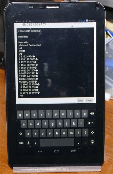

Update 26 - Functional Impact Event Capture & Bluetooth Download
Below is a demonstration of the Crown Tools helmet impact recording electronics and firmware. It is designed to record up to 50 impact events, capturing the time of impact, the peak acceleration and the impact energy of each event. The peak acceleration is the peak of the resultant magnitude calculated using vector addition of the 3 individual axes of acceleration. The impact counter will continue to count events beyond 50 and the display will always display the latest impact event data, but there is not enough memory to save more than 50 events. I may increase this if I have time, but 50 events should be enough for any reasonable activity.
It is near the end of the original March deadline for this challenge and  both the Crown Tools and the Heart Reactor have fully functional electronics and firmware and both can talk to Bluetooth devices, so although the deadline has been extended, this project could have been completed on the original schedule. There were the usual development issues and delivery problems and I was pretty sick for a while and did slow down for a few weeks, but it looks like things are coming together quite well, barring any catastrophic failures or external events.

Here is an image of the data as displayed on my android tablet back at my house after the game:
Note: I first connected to my Henrietta Project (GPS clock) before remembering which Bluetooth device was the Crown Tools.
The first column is the event number, the second number on each line is the elapsed time in seconds, the 3rd number is the peak acceleration (divide by 10 to get g's - I do this to avoid using decimal points) The last number on each line is the area under the acceleration curve - or equivalent drop velocity in mm/s if it is divided by 2.
The "0" event occurred 6 seconds after power up - I slapped the helmet before putting it on to check that it was recording properly.
