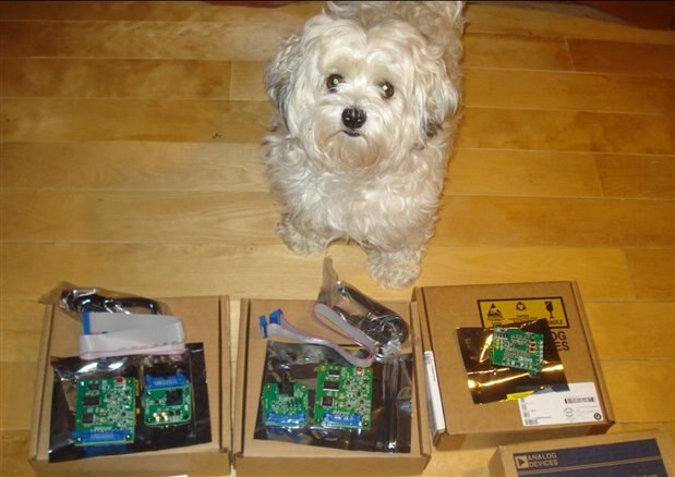

I was very excited, so I opened the box, I took out the contents, and I put them on the floor for a “group” picture.
I was taking pictures admiring all the evaluation modules and thinking which one to start with first, until the dog found me and I had to quickly move everything on the table.
Luckily the electrolube resin pack was not there so the dog missed the opportunity to chew on it image

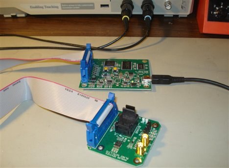

Then I started to experiment with one of the inertial accelerometers, the EVAL-ADXL362Z-MLP kit.  Downloading and installing the software went smoothly and in a few minutes I had the evaluation board functional on my test bench.  Here is a picture of the setup:

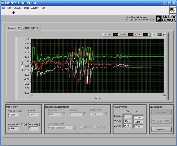

And here is a screenshot of the GUI software panel on the computer:
The three waveforms represent the continuous monitoring of inertial acceleration on x, y, and z axis.  The “wiggles” are the result of me moving the sensor up and down, left and right, and forward and backward.

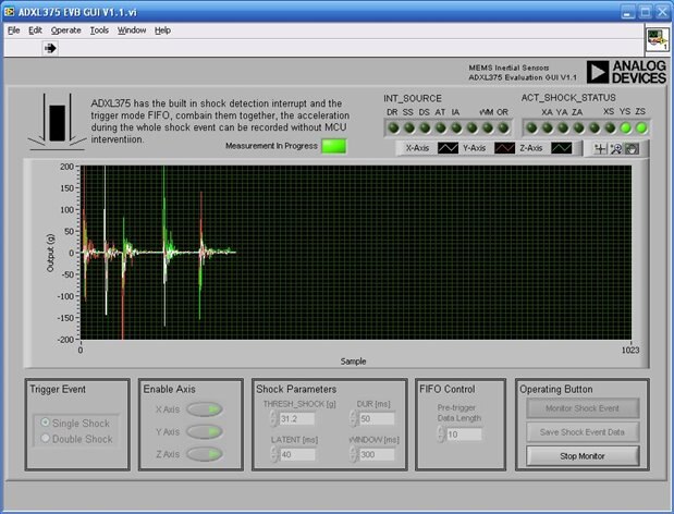

Next I downloaded and installed the ADXL375 software and I connected the EVAL-ADXL375Z-M evaluation kit to the computer.  Here is a screenshot of the GUI software while recording continuous movement of the sensor.
The wiggles are smaller than for ADXL362 sensor since this ADXL375 is a high-g (+/-200g) type sensor, and the vertical scale on the graph spans a larger range.  What I liked at this sensor is that it has a FIFO and an interrupt/trigger mode in which in case of a mechanical shock it records for a few milliseconds the entire impact waveform on all three axes.  Here is an example screenshot where I applied five mechanical impact shocks to the sensor from different directions.
The GUI software waits for the shock and immediately after the shock it displays the waveform.  The trigger level for recording a shock is adjustable, and the length of the FIFO that stores the data is also adjustable.  This function is very useful for my wearable sudden impact and health monitor, since it acts like a “stand-by” routine that in case of a sudden impact it provides the detailed waveforms for further evaluating the impact on the athlete/player.
