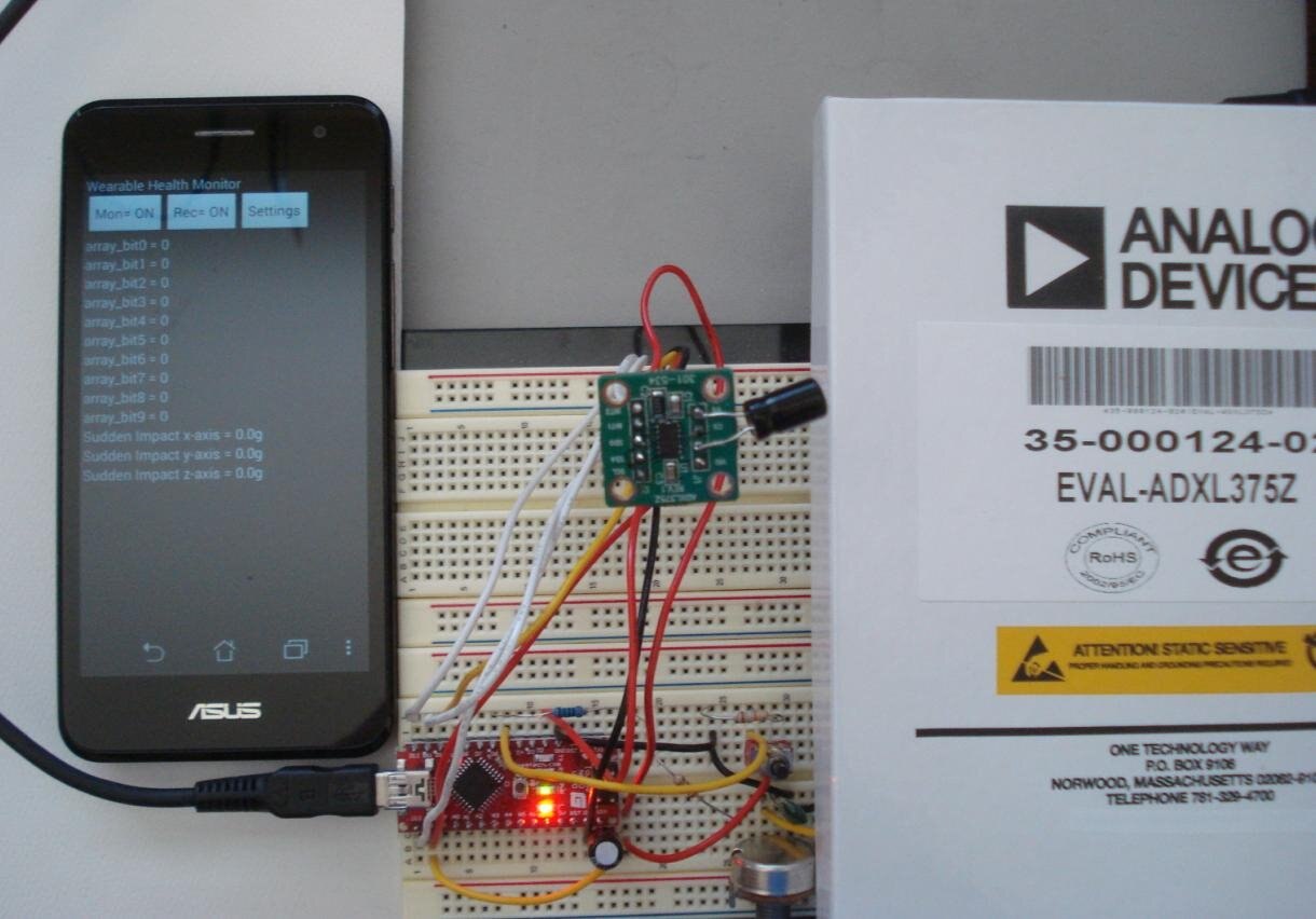

Hello Everyone, here I am back with another update on my "Wearable Sudden Impact and Health Monitor" project.  After receiving the materials and playing a little with the Analog Devices ADXL362 and ADXL375 evaluation kits, as I mentioned in my previous blog post, I started to work on my project.  So I took the Analog Devices module EVAL-ADXL375Z and I connected it through SPI interface to an Arduino nano board.  Here is a picture of the setup:
The ADXL375 modules is hanging on those wires, which are then plugged into the breadboard that holds the Arduino nano module.  The measured data is then sent to the phone that sits on the left side of the breadboard.

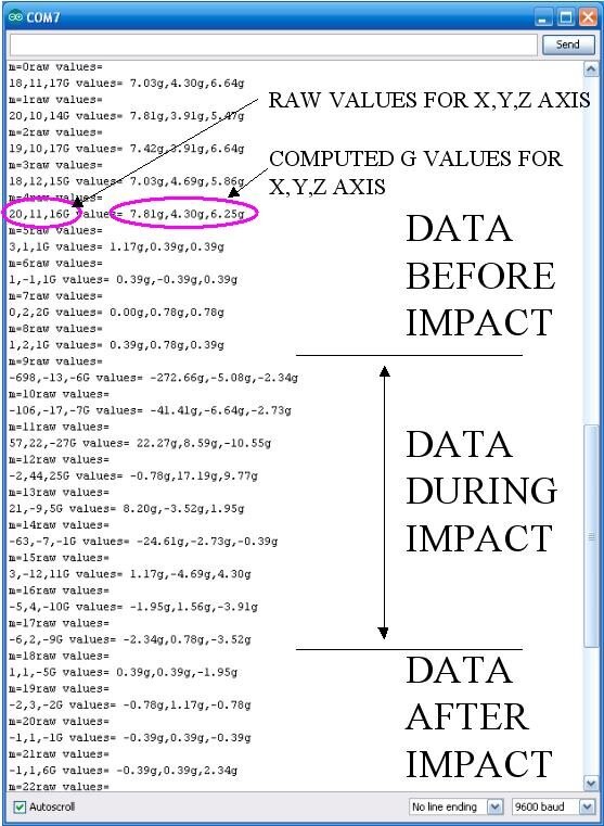

Then I wrote a program that collects the x-axis, y-axis, and z-axis data from ADXL375 in case of an mechanical shock (sudden impact).  Here is a screenshot example of measured data:

  • hlipka
    hlipka over 11 years ago
    Strange: the ADXL375 measures up to 200g, yet I see one -272.66g value in your list. So maybe something in your conversion is wrong?
    mcb1 over 11 years ago
    Nice work.
    It's all coming together like a well oiled machine.
