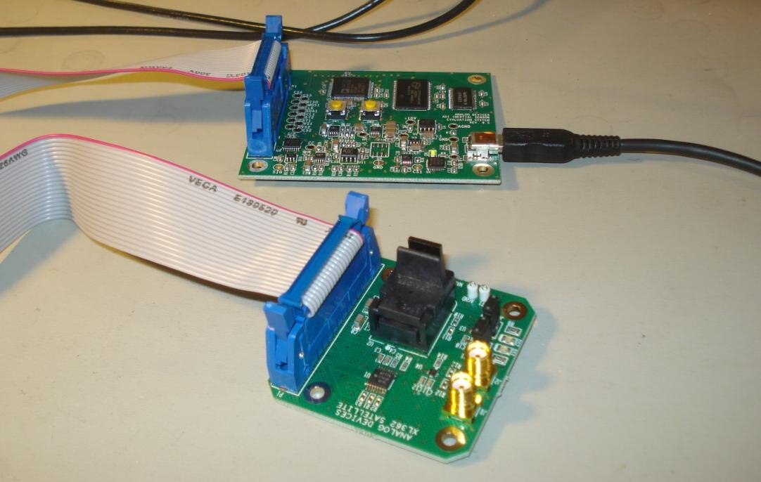

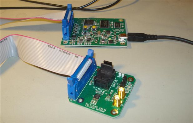

Interestingly, as it has been mentioned by hlipka in the comments, my measured values exceeded the ADXL375 spec of maximum 200g.  So I have spent some time to verify how I converted the raw data into g units, and I came to the conclusion that my calculations are correct.  So I came to the hypothesis that maybe my ADXL-375 measures more than 200g.  To test my hypothesis I plugged in the other evaluation kit for ADXL-375 that I have, EVAL-ADXL3745Z-M, which runs trough a GUI provided by Analog Devices, so I exclude any potential calculation errors that I could make.  Also, this kit uses a different ADXL-375 sensor chip than I used in my previous experiments.  Here is a picture of that setup:

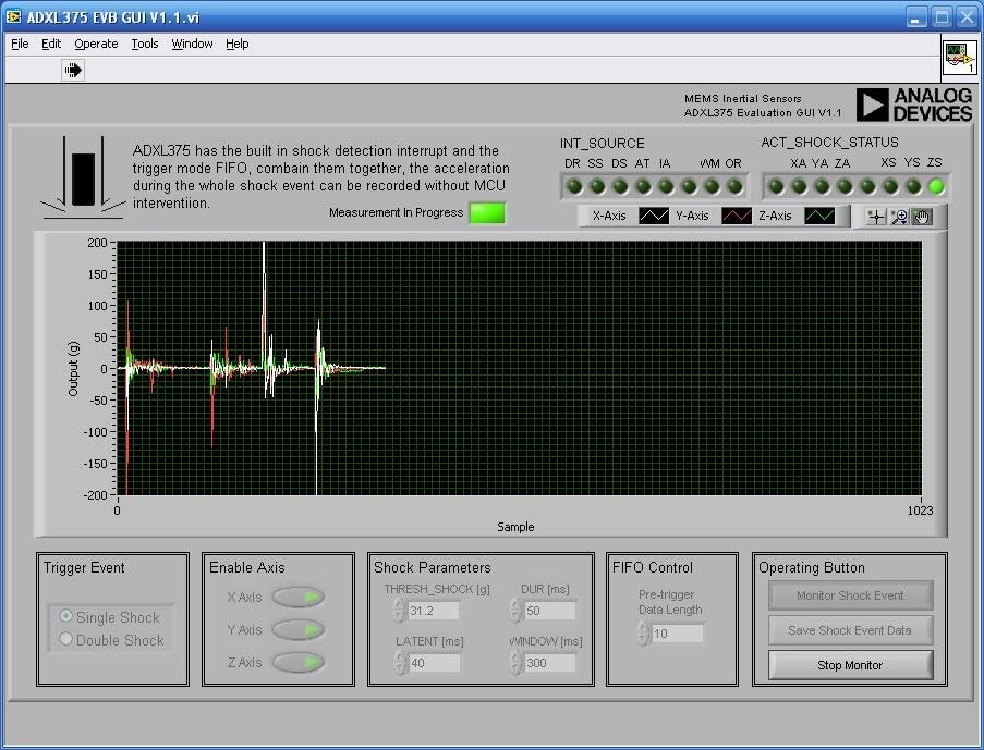

On this experimental setup I then applied the same impact force that I applied on my previous experiment.  I then looked at the impact recording on the GUI and indeed it looks like the measured value exceeds the maximum range of 200g on the y-axix of the GUI graph.  Here is a screenshot of this measurement.

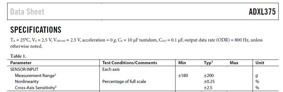

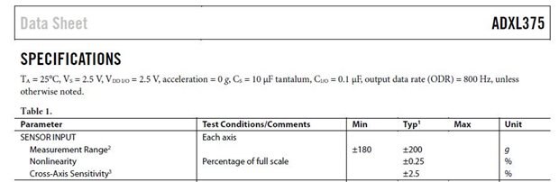

I then looked at the datasheet; here is a screenshot of the section describing the maximum range:
So the typical range is +/-200g, there is a minimum range shown there of +/-180g, but there is no maximum range value, so the specifications allow the possibility that the ADXL-375 sensor may be able to measure accelerations larger then 200g.

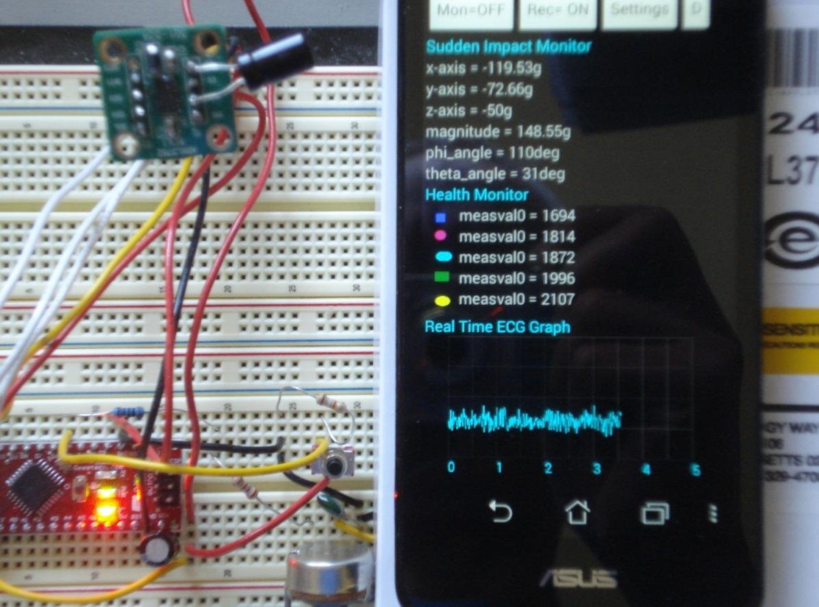

After clarifying that I did not make any error in converting the measured data into g values, I continued with improving my Android app by adding a graph that will display the real time ECG measurement.   This was not an easy task, so I spend quite a significant time to get it to work.  Here is a picture of the app running on my phone, which has the graph displayed at the bottom.
And here is a video (I don’t know why the resolution is so bad; I need to look for a different camera for future videos).  The video shows a square wave signal plotted on the graph, since so far I haven’t connected yet the AD8232 ECG eval kit.
