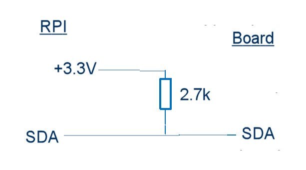

    shabaz over 11 years ago in reply to hawkeyethehacker +1
    The SDA and SCL pins are floating, and need to be connected to +3.3V using resistors, i.e. basically something like this (and repeat for the SCL line too). And connect the 0V line between the board and…

    Hi Joshua,
    From what I can tell, the eval board doesn't have pull-ups, and I've no idea if the RPI has pull-ups, but I suspect it doesn't. In that case, you'll need a couple of resistors, i.e. something like 2.7k resistors from the SDA and SCL lines to +3.3V will be needed.
    Good luck with your project!

    0 shabaz over 11 years ago in reply to hawkeyethehacker
    The SDA and SCL pins are floating, and need to be connected to +3.3V using resistors, i.e. basically something like this (and repeat for the SCL line too). And connect the 0V line between the board and the RPI too.
    1k is a bit low, something between 2k and 5k is good. If you don't have this, use (say) two 10k resistors in parallel to get you 5k, or two 1k resistors in series to give you 2k.

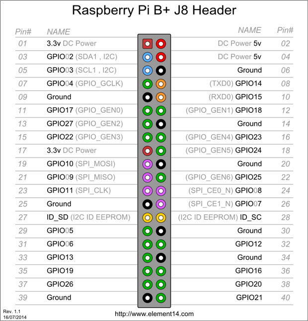

    I have the module connected as follows:
    RasPi GPIO Pin No.Breakout Board
    3V3VCC
    GPIO2Data
    GPIO3Clock
    GroundGround
    I don't have a photo yet but I'll try and get one taken tomorrow. Thanks for your help, everyone.
    EDIT: Adjusted Pin Name above in regards to the comment below
    Hi Joshua,
    Did you really mean GPIO5, or did you mean pin5?
    The clock should be connected to pin5, i.e. GPIO03. Could you confirm this is what you've got?
    Similarly for Data, that should be pin3, i.e. GPIO02.
    These are the blue pins in the image below.
