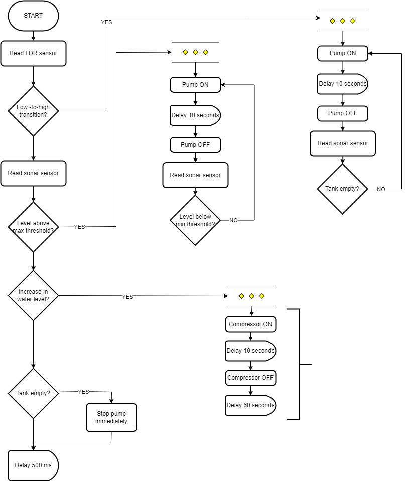

1.4 The control logic
The control logic implemented to mange the sedimentation tank follows these rules
  1. on dawn (i.e. when light detector output switches from 0 to 1), pump all the water in the tank to the reed bed. This is to avoid to store greywater for more than 24 hours
  2. when water level reaches the maximum limit, empty the tank until a safe level is reached
  3. when water level raises, switch on the compressor to create an oxygen-rich environment
All these rules are shown in the following diagram
