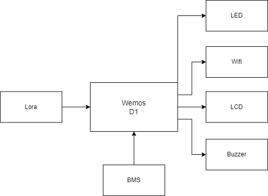

Second Node (Receiver)
The second node series consists of Lora as data input from the first node, the data results are processed using Wemos D1, and the output is data sent via the WiFi network to Firebase and displayed on the Oled LCD. The resource of the second node is a battery that can be recharged.

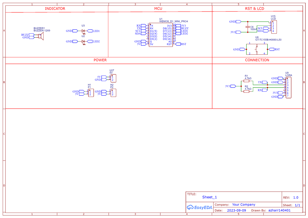

The second is the process of creating a circuit schematic.

The following is a schematic of the second node circuit (Receiver):
The same goes for the second node I added filtering in the form of a resistor to make Stable LoRa data delivery. Apart from the filter circuit, I added a reset button in case of an emergency if the circuit has an error and an indicator in the form of an LED to indicate the status of the device having an error or working well. If there is an error then the red light will come on and if not then the green light will come on.
