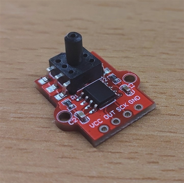

The display is extremely easy to use with the Adafruit library, but this is something I will get into more detail about in one of the next blogs. On the picture with the whole device drawn, in the bottom-right corner, you can notice "Additional GX12 connectors". My idea is to have at least 2 connectors on the side that can be used or not, one would be used for a pressure sensor unit and the other one would be used for a clamp-style oximeter using the other click board. Using a clamp instead of just placing a finger on top can have some benefits like ambient light shielding and a person not being able to press on the sensor too hard/soft which can give faulty readings. As for the pressure sensor unit, this is my idea.

    Thanks, glad you like them! That's a pretty good idea, haven't looked at it like that, but now when I think about it, the goal would be for the device to automatically do all of the readings with the pressure sensor, so the pots would just clutter if everything works as expected. I'll for sure keep the pots as a separate module now, but I'll try to make that module like a snap fit add-on, so there are no additional cables or anything like that, and it can be left attached to the device if the pressure sensor doesn't work out.
