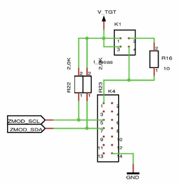

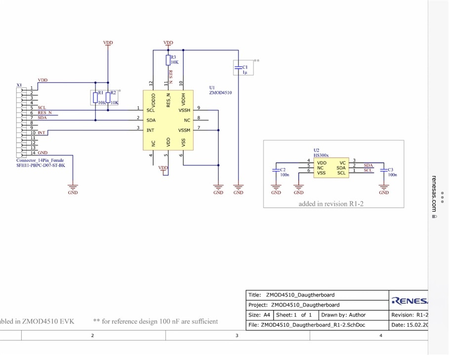

Looking at the schematic for the daughterboard, it shows that pin 1 is VDD, pin 14 is GND, pin 5 is SCL, and pin 7 is SDA.
ZMOD4510 sensor schematic

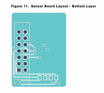

The documentation also includes top and bottom diagrams of the sensor daughterboard, which helps identify the pin configuration.
ZMOD4510 sensor topZMOD4510 sensor bottom
The schematics and images also include extra information for the revision 2 humidity sensor, but my board is the older version, so those parts don't exist for me, and can be ignored.
The connector part of the HiCom board schematic confirms the pinout:
ZMOD4510 HiCom connector schematic

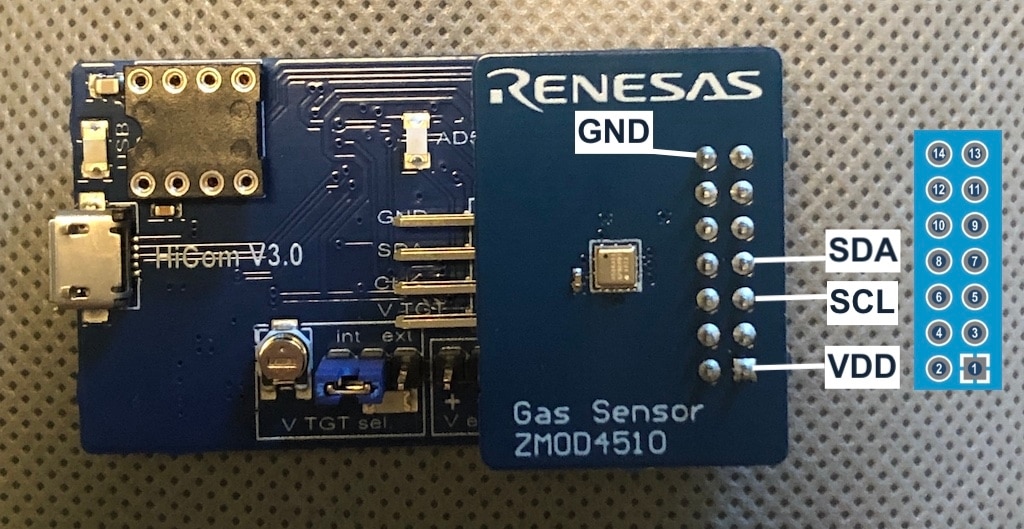

Putting it all together, using a picture of my ZMOD4510 boards, I came up with this:
ZMOD4510 picture with pinout
Now, I know what you're thinking: "Nico, you screwed this up last time with the HS4001 pinout!" Laughing, and I was thinking that too, which is why I double and triple checked the documentation before hooking up any wires!
Note that I will remove the daughterboard from the HiCom board to use it with my Arduino. The HiCom board is only used for testing with the Renesas Windows application.
