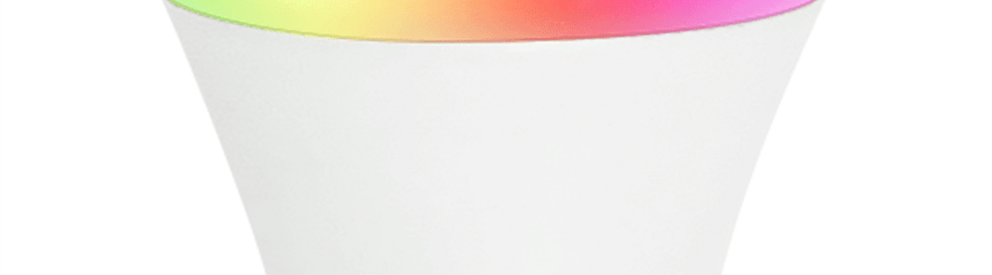

What is a Smart Bulb?
For those who do not know, a smart bulb is a light bulb that connects to a wireless network and incorporates a remote control interface, usually via a smartphone app. Smart bulbs can be connected directly to a smartphone (point to point network topology), connected to another smart bulb (mesh topology), or connected to a central hub.
Generally most smart bulbs use an LED (Light Emitting Diode) light source rather than traditional incandescent, halogen or flourescent light bulbs. This provides many advantages including reduction in power consumption and the ability to digitally control the brightness and colour of the emitted light.
Smart bulbs, like regular light bulbs, are available in most of the standard fittings. This is identified by a single letter followed by a two digit number. The letter designates the fitting type, “E” for “Edison Screw” and “B” for “Bayonet”; the number indicates the diameter of the fitting. For example, the two most common light bulbs in the UK use the E27 (27mm diameter screw) and B22 (22mm diameter bayonet) fitting.
