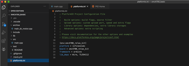

This XMC4700 relax kit has been around for a few years. This has an Ethernet port so we can run a webserver for remote control and data analysis later in this project. Just like XMC4200 development kit, the board is compatible with the Arduino Uno pinmap and it has 3.3V and 5V digital IO voltage options. Platform IO supports this XMC4700 board, so it was very straight-forward to create a new Arduino project on Visual Studio Code from a scratch.
Platform IO configuration file in the picture below.
TLE94112 library was available on PlatformIO image

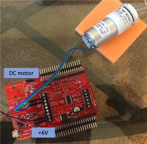

2.   DC Motor Shield Control by XMC4700

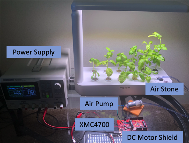

DC Motor Shield can be mounted on XMC4700 dev kit through the Arduino Uno compatible pints. The DC motor for air pump required 6V DC voltage. So, 6V is applied to the VBAT from a bench power supply (Siglent SPD3303 Power Supply).

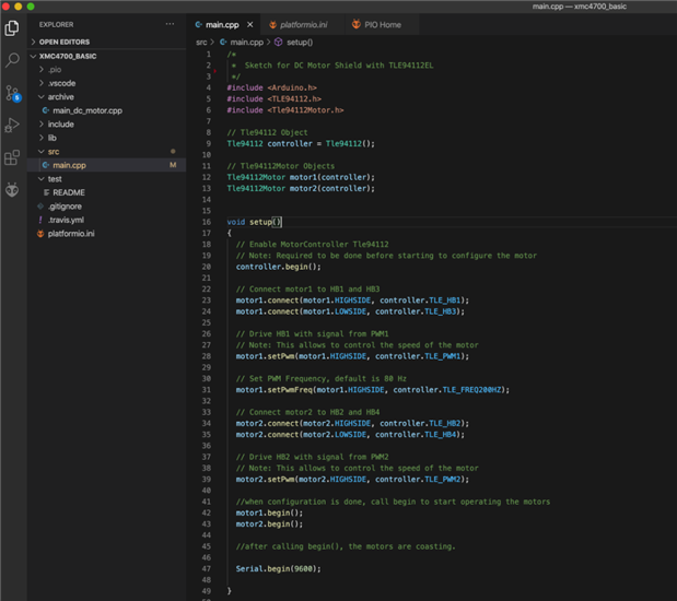

3. DC Motor Shield Control from XMC4700
DC Motor Shield source codes are available on github by Infineon. They are easy to use and there were good examples. So, I just integrated the available codes to the Platform IO XMC4700 project.
At this point, we can control the motor by a couple of lines of codes inside the  Arduino loop function.

4. Integrate the current system to the hydroponic system.

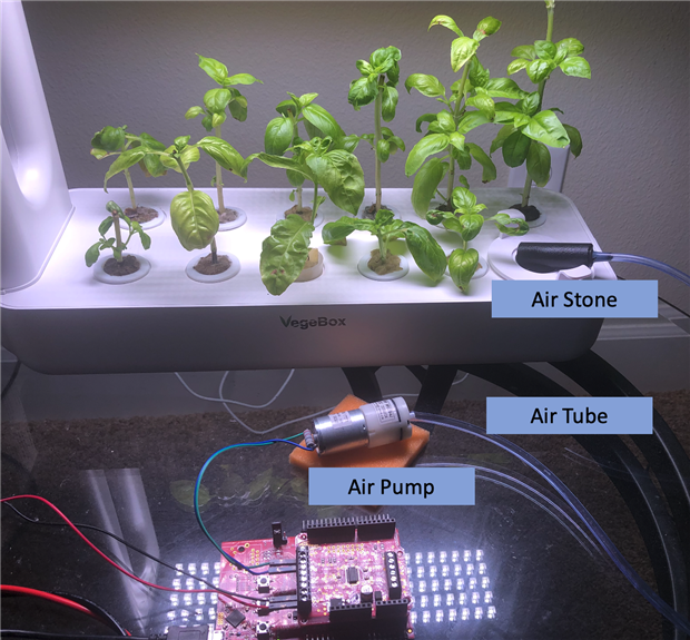

To start running this air pump, at least 80mA current was required by changing the value of the motor speed in API and measuring the current. The speed of the motor needed to be at least 100 (maximum = 255). The air pump vibrated and made some noise when it was running. So, one sponge was added under the motor. This air stone can be inserted into the hydroponics system to add some oxygen into the water. I used a commercial hydroponic system by VegeBox because this box has LED lights and I wanted to add photo-resistor as a next step.

    DAB over 6 years ago +1
    Have you looked at your rail voltages to see if there is any EMI introduced by the motor? DAB

    kurama007 over 6 years ago in reply to DAB +1
    Hi DAB, yes. There are EMI noise at the rail voltage. By a quick test, it is about 30mV.
    DAB over 6 years ago in reply to kurama007
    You might want to consider separating the motor power from the logic power to see if you can reduce the EMI.
    You could also put some ferrite toroid blocks on the motor wires to cut the EMI.
