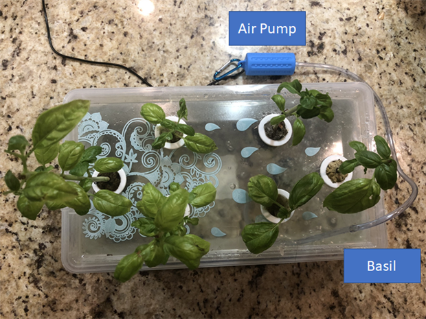

Here is a video of my hydroponic system called YOSO (You Only Set-up Once) !
Indoor Hydroponic System Videos are here at this website: https://green-scientist.com/indoor-gardening/

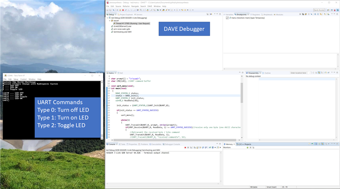

Software Environment: From UART (TeraTerm), a user can type 0, 1, or 2 to turn off LED, turn on LED, or toggle LED (on--> off or off --> on).

1. Get familiar with Infineon DAVE IDE
This is my first time to use Infineon microcontrollers. So, I didn't know where to start. Fortunately, the XMC4200 product website has nice documentation. So, I was able to follow the instructions. The software development kit was a bit confusing at the beginning as it says the Arduino compatible. However, XMC4200 is still a new product and Arduino IDE and Platform IO are not supported yet as of August 3, 2020. The only pins are compatible with Arduino Uno. So, I tried using Infineon DAVE IDE based on Eclipse. The experience so far is very good. There are two USB ports on XMC4200, and I only use the one on "Debug" side, so I can use the DAVE debugger flawlessly.

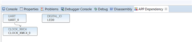

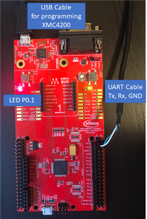

2. Turn on/off/toggle LED
Usually, the first software application is either a Hello World or blink a LED with an embedded system. I tried a LED application for the first time. The LED configuration requires a DAVE UART application. The XMC 4200 Platform2Go comes with an on-board LED as part of Digital IO, which is assigned as P0.1 as a pin name.
Here are Digital IO commands that I used.
  • DIGITAL_IO_SetOutputLow(&LED0);
  • DIGITAL_IO_SetOutputHigh(&LED0);
  • DIGITAL_IO_ToggleOutput(&LED0);
This is a DAVE app block diagram.

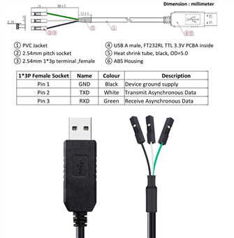

3. UART communication between a XMC4200 microcontroller and computer
    To control the microcontroller and sensors later, I would like to have a debug UART console. Inside DAVE, we can enable UART and I have a USB-to-UART cable which can be connected to P2.14 an P2.15 pins. So, I connected the USB-to-UART cable with three wires like the picture below. This cable came with a FTDI FT232RL chip.

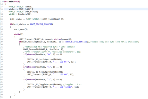

4. Develop a small application involving UART and LED
The small application starts with initializing the UART communication between a PC and XMC4200 microcontroller. Then, depending on the user input (ex: 0, 1, or 2) , XMC4200 takes action on the LED.
Code Snippet
5. Hydroponic System
Here is the simple hydroponic system that I built. The building instruction is summarized in my website here. https://green-scientist.com/2020/05/16/diy-hydroponics-under-10-mins-with-basil/
