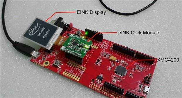

In the previous blog7  i have finalized the setup and in this blog I'm going to add Eink display to the XMC4200.
The Eink display ( eINK Click board ) i have got from the Mikroe and i'm using the 1.5Inch EPD display.
SPI Interface:
The EPD is interfaced to our XMC4200 with SPI interface. The board has an Mikroe slots we need to insert the module.
Pin Details:
#define EPD_RST      P2_7
#define CS         P0_7
#define SCLK     P1_8
#define MOSI     P1_9
#define DC       P1_1
#define BSY      P0_10
The SPI frequency is configured with 2MHZ in default mode zero.
And i have disabled the MISO & CS , CS pins is drive via GPIO port.

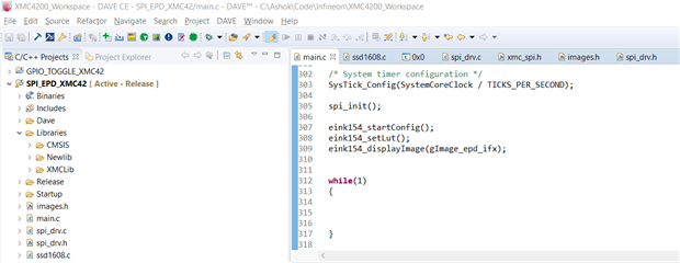

EPD Initialization:
The pins are initialized  driver code is downloaded from Mikroe.
  XMC_GPIO_Init(EPD_RST,&config);
  XMC_GPIO_Init(DC,&config);
  XMC_GPIO_Init(CS,&config);
  XMC_GPIO_Init(BSY,&input_config);
Creating Project:
Checkout the blog3 for creating an project from existing project. In addition i have added the ssd1608 drivers and Image
binary.
I have created an 200x200 size image and converted into bitmap array and displayed with the EPD drivers.
  eink154_startConfig();
  eink154_setLut();
  eink154_displayImage(gImage_epd_ifx);
The final output of this code will print the image on the display.
