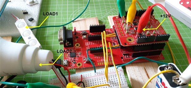

In my case I have stacked this shield on top of the TLE94112L shield. the setup looks like below

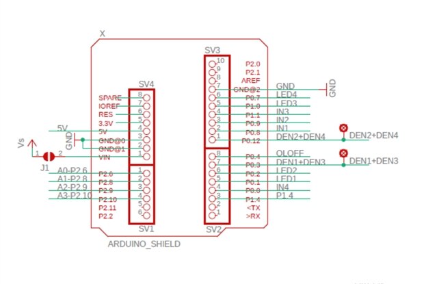

Control the Outputs:
Its very simple to control the OUT of BTS7002 by setting high (3.3v) on the IN Pin. In my case i have choosed
IN1 & IN4 to control the OU1 and OUT4.
Schematic:
configured the XMC4200 Pins P0_11 & P2_2 as output
  XMC_GPIO_Init(LOAD_IN4,&config);
  XMC_GPIO_Init(LOAD_IN1,&config);
and toggle the pin inside the SysTick Handler
    XMC_GPIO_ToggleOutput(LED1);
    XMC_GPIO_ToggleOutput(LOAD_IN4);
    XMC_GPIO_ToggleOutput(LOAD_IN1);
Make sure that BAT+ is supplied with 12V , I have used 12V 7.5Amps solar battery.
I used 12V LED strips/lights as load for my use case. And finally I could control my lights with a high current profit shield.
