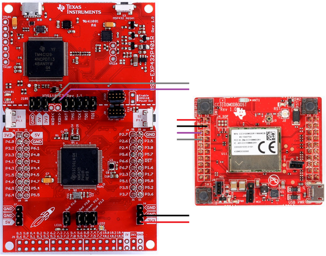

The MSP432 LaunchPad (and many other LaunchPads) have this on board. The debugger is a USB to COM to 3V3 UART bridge.
I have tested this with an older version of the LaunchPad that has a different block of jumpers (the black MSP432 with pre-prod controller silicon).
Remove the jumpers of the RXD and TXD signals.
connect RDX with BoosterPack 1.4(TX), TDX with 1.3(RX)
connect a GND of the LaunchPad with a BoosterPack GND, and a 3V3 with a 3V3.
Connect both boards via USB to your PC. When connecting the LaunchPad, write down the COM port it gets assigned.

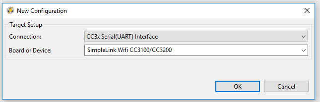

Now start UniFlash and choose New Target Configuration. (here's a short guide for our BoosterPack)
Select CC3X Serial(UART) Interface, then select the only available Board or Device option.
Press OK.
Enter the COM port that's assigned to the MSP432 UART
Press the Get Version button.
When the first red line appears in the UniFlash console, press and release the BoosterPack's RESET button (SW2).
Watch how UniFlash connects and logs the version info of your CC3100.
Then press the List File System button. You need to push the RESET every time UniFlash engages with the BoosterPack.

    I checked if this works with a CC3200 LaunchPad as UART bridge: yes
    Write down the position of the jumpers J6, J7 and J15.
    Put Jumper J15 in position 2 to allow UniFlash functionality
    Remove Jumpers J6 and J7
    Connect the top pin of J6 (RX) to BoosterPack J1.4 (TX)
    Connect the top pin of j7 (TX) to BoosterPack J1.3 (RX)
    GND to GND, 3V3 to 3V3, connect both USB cables.
    Don't forget to push SW2 (Reset) of the CC3100 briefly during connection)
    Afterwards, put the jumpers back to their original position.
