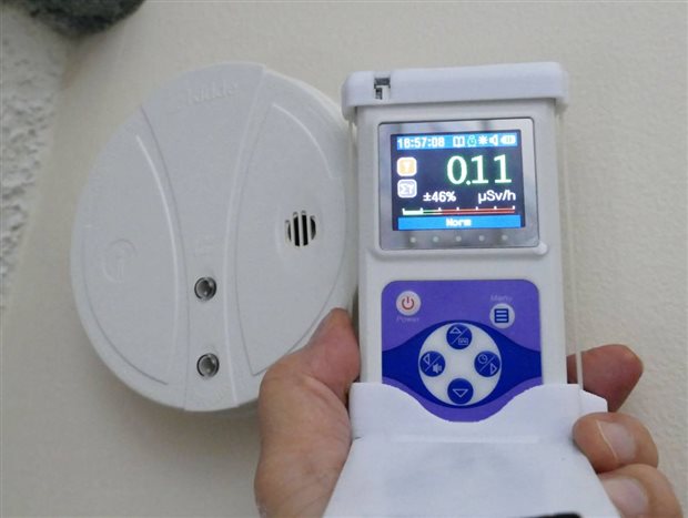

In a previous blog a discussion came up about the use of (radioactive) Americium in smoke detectors so here is a follow up with some tests.
Here is a picture of what my radiation meter reads when next to a smoke detector in my house:

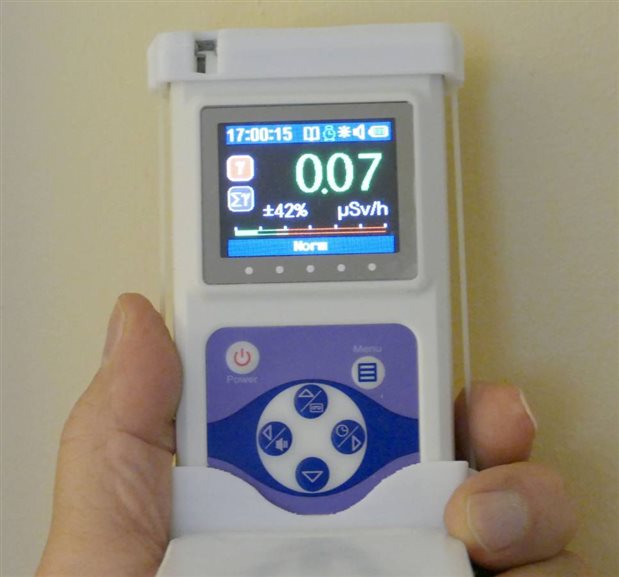

Here is a picture of the background radiation in my house:
The meter is pretty nice in that it provides an accuracy estimate as well as a reading. The accuracy in these readings is no better than 40% because the meter was not running very long and the amount of radiation is very low. Which means these readings could be the same real value although the smoke alarm area was consistently very slightly higher than other areas. Whatever radiation is reaching the meter is probably gamma radiation as I don't see how alpha particles could reach the meter with any velocity. My conclusion is that any radiation from the smoke detector is pretty similar to background radiation and generally the background radiation will be larger than any contribution from a smoke detector.
