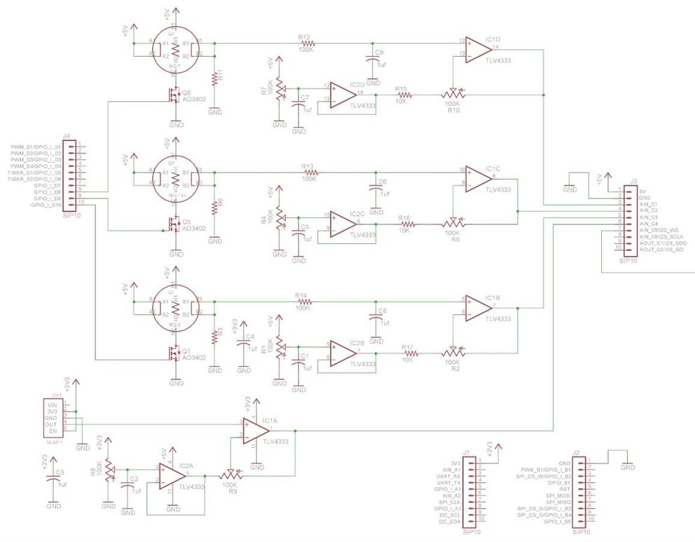

This project does not focus on most of these substances because they can often be detected by our sense of smell. However the custom Booster Pack for this project will have 3 sockets that can accommodate any of the MQ-x sensors. Initially the 3 sockets will monitor:
  1. Carbon monoxide (because it is ordorless and dangerous) with an MQ-7
  2. Air quality (ammonia, sulfide, smoke, Benze) with an MQ-135
  3. Benzene, alcohol, ethanol, LPG with an MQ-3
The later 2 sensors were chosen mainly because they are low cost and I am curious how well they detect smoke and alcohol. MQ-135 is billed as an air quality sensor and it will be interesting to correlate its output with the CO2 level, which is also supposed to be an indicator of air quality.
These MQ-x sensors change their resistance in the presence of the target gas. They also have a heater to make the resistance change measurable. The heaters need to be cycled, so they each have a FET to turn on their heater. Suggested heating cycle is 60 seconds on and 90 seconds off, but since I only want to run one heater at a time to reduce battery current, so I will run each at 60 seconds on and 120 seconds off (while the other heaters cycle sequentially). Here is the circuitry that will be used to translate the output to match the A/D input range:image
The connectors on this schematic are the Booster Pack interface connectors for the MSP-EXP432P401R

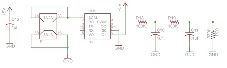

To measure CO2 I will use a SenseAir S8 miniature infrared CO2 sensor module. This fairly delicate module normally uses serial communications, but since I will be using all the serial ports for display and RF communications, the module's PWM output will be converted to an analog voltage.
Here is the circuit I will use to interface the CO2 module, including a calibration button:
The switch is used to calibrate the sensor - hold it for 6 seconds in a standard CO2 atmosphere or 16 seconds for a zero CO2 atmosphere.
