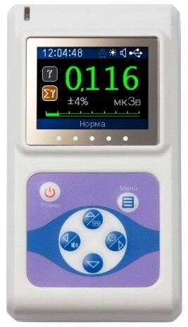

So, after all this research, it turns out I probably can't build a sensor that will safely measure radon concentrations in a reasonable time frame. I did order a radiation detector that can measure alpha particles, beta particles (high speed electrons) and gamma radiation, but I will just use it to see if it can detect anything in my environment. For example many smoke detectors have a radioactive source (americium). Americium produces mainly alpha particles which won't escape the smoke detector package. There is also some weak gamma radiation at about 59 KeV, so maybe it is detectable.
I chose this Radiascan 701 detector because:
  • It uses an ARM Cortex M3 for faster computation than competing products
  • It has a USB port allowing data to be read by an external computer
  • The USB port allows extended operation from USB power without depleting batteries
  • It is a very sensitive, high accuracy detector capable of detecting alpha, beta, gamma radiation and it has many features
Here is my 3D printed desk stand:
I am also designing a 3D printed wrist-mount for this sensor and expect to blog about test results using it in my environment.
