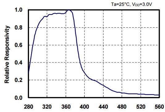

This sensor has a spectral sensitivity that almost perfectly captures the UVA and UVB spectrum as shown here:

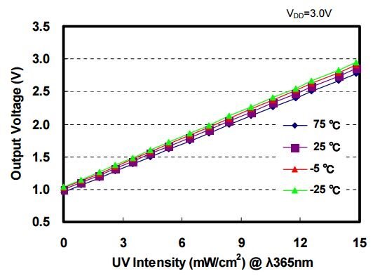

This next graph shows the sensor sensitivity to UV.

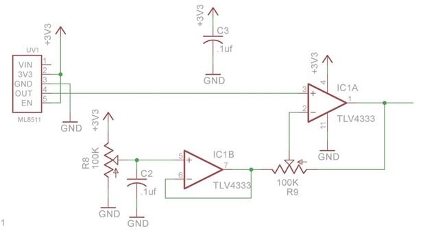

If I am reading all these numbers correctly, it looks like this sensor is not ideally sensitive to the levels of UV in sunlight so the signal may need extra gain. I will use a general purpose offset and gain adjustment circuit to ensure I can get reasonable readings in normal sunlight. The Texas Instruments TLV4333 quad op-amp I am using is a nice accurate, low offset, low drift, rail-to-rail amplifier well suited to low speed sensors. This circuit will connect to one of the analog channels on the MSP_EXP432P401R.
This circuit will be one of 4 or 5 sensors on a custom booster pack I am designing.
I will probably tackle the other sensors on this booster pack next as I need to design the PCB and get it on order.

    Great post Douglas. Interesting sensor you found. I am assuming it is silicon based with a UV filter, but I am just guessing. I look forward to seeing you design. DAB
    mcb1 over 9 years ago +2
    Given the UV problems, it's a shame low cost devices with reasonable output are not prevalent. Look forward to the other sensors.
