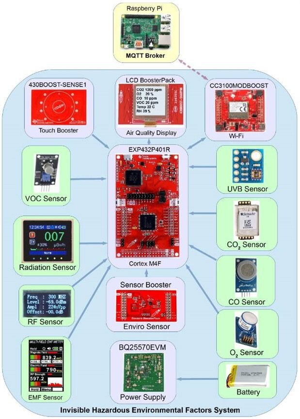

System Concept
The instrumentation that I am proposing to use to monitor the invisible entities outlined above takes up a considerable amount of physical space, as does the supplied kit of modules to be used in the challenge. It could easily fill up a backpack, but in order to better meet the wearable requirement, I will package all the instrumentation in a forearm-mounted modules. Although it will be too large for everyday wearing, I want to at least make it wearable, useful, ergonomic and aesthetically professional looking.
The plan is to have 4 displays, a touch pad, and UV sensor lined up along the top of the forearm, one of the displays will be the Sharp graphics LCD that is part of the challenge kit.
Display 1 - a,b,g, x radiation
Display 2 - EMF (ELF magnetic field, electric field, & RF)
Display 3 - microwave & RF field strength
Display 4 - UV & air quality (O2,CO2,CO,VOC)
Along the inside of the forearm will be the computer module and Wi-Fi Booster (parts of the challenge kit).
Along the outside of the forearm will be a suite of environmental sensors.
On the underside of the forearm will be the battery and power supplies.
At least 2 of the instruments will need mechanisms to fold away when not in use. Each folding mechanism requires five 3D printed parts.
At least 10 of the modules will require 3D printed cases to mount on the sleeve, where each case may need 2 or more 3D parts.
Aside from 3D parts, the mechanics of the system will need some soft goods, pads and straps to attach comfortably to a forearm.
Electrically the air quality sensor suite will require a custom (Booster Pack) PCB to turn them into a module.
Firmware will be needed to read and display sensor data, and I would like to publish the data on an MQTT broker since the kit includes a Wi-Fi module. Hopefully I can use a Raspberry Pi as the MQTT broker.
System Block Diagram
Summary & Notes
This wearable environmental factors instrumentation system is a fairly ambitious project with many challenges, but I find the subject matter and chance to learn and stretch my capabilities very motivating. Although there will be a lot of work associated with sourcing and procuring instrumentation, learning device characteristics, designing and building hardware and programming firmware, most of it is the type of engineering I am familiar with. The main risks for me are learning and trusting other people's software, such as MQTT broker software, but it is a good opportunity to explore this interesting technology.
There is a significant problem in finding low cost sensors that will interface to a computer while providing reasonable data, so part of this project is a fairly comprehensive search for suitable instrumentation. This has already been researched enough to build the above block diagram, however there are a lot of peripherals in the plan and I have not done enough detailed design yet to know if there are enough pins on the MCU to interface with all of these devices. There are 4 Booster packs from the supplied kit in my block diagram but I'm not sure even these can all work together – they certainly don't look stackable.
I still expect the design challenge modules kit should make a fine wearable platform with an  MSP-EXP432P401RMSP-EXP432P401R MCU a  CC3100MODBOOSTCC3100MODBOOST Wi-Fi link and a  430BOOST-SHARP96430BOOST-SHARP96 LCD forming the core platform The core platform can always be extended as new peripherals become available or feasible

    Very interesting project. I will be following your progress with great interest. I might have a use for some of your sensors for other projects. DAB
    Jan Cumps over 9 years ago +2
    There's an example MQTT project for the MSP432 + CC3100 combination. It's not secure in its current incarnation though - plain tcp/ip.
    Jan Cumps over 9 years ago in reply to dougw +2
    It's a bit of a coincidence. I'm developing an application on the MSP432 - and each of the blogs is something I need(ed) myself. In the end not everything will make it into my app - I won't use the WiFi…
