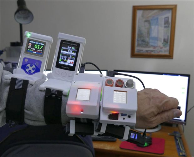

This design challenge is nearing its final deadline so the pressure as been building to complete the project.
I finally finished building all the hardware and all the hardware is working well.
The past week has seen a lot of 3D design work and 3D printing and mechanical building, but also powered up the full system for the first time.
The subscriber power monitor is showing 5.08 volts at 10 mA.
The publisher power monitor is showing 4.97 volts at 190 mA.

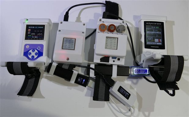

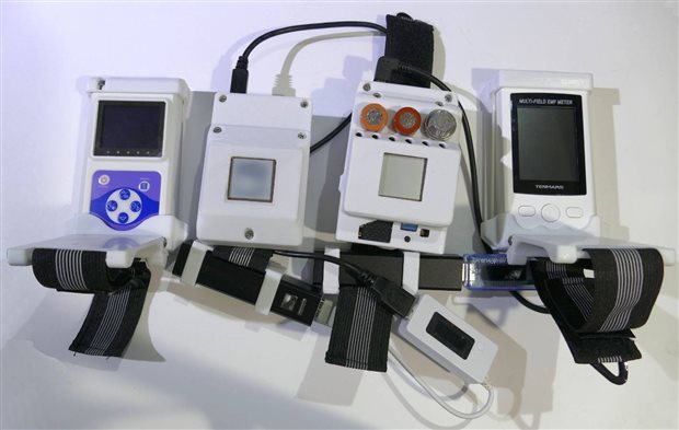

Here are the four instruments that make up the Invisible Hazardous Environmental Factors system.
Note the 2 USB power monitor modules are not part of the system - I was just checking how much current the systems consume.
(10 mA and 240 mA respectively)
If you look closely - you can see the CO2 is reading 463 ppm, which is bang on - a really nice quick sensor.

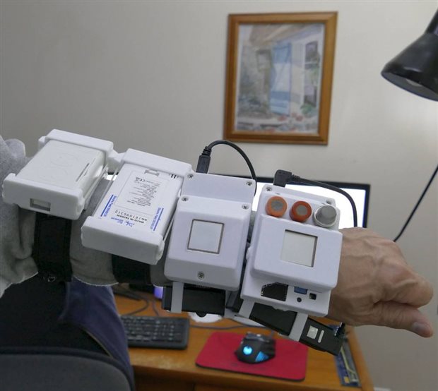

Here are the 4 IHEF instruments on one forearm. They barely fit.
Here is the IHEF system running. After wearing the system around for a while I am re-thinking my desire to build a Pip Boy - the weight of the full system is non-trivial.
There are a lot of LEDs on the embedded modules - I like the way they shine through the plastic housings. You can just see the green coming out the side - the yellow are mostly visible in the video.
As with any project of this complexity, there was a lot to learn and a lot of issues to work through, but on all the major tasks careful planning and design paid off.
