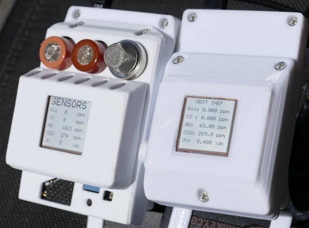

I did a quick experiment on dwinhold suggestion to see if I could measure sunscreen lotion performance.
In the following 3 images the actual UV Index is always 5.48 as shown in the first image with no sunscreen.

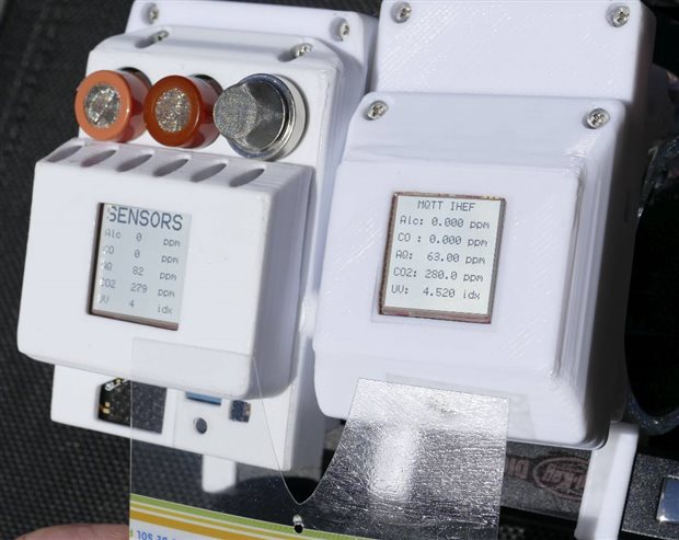

The second image shows the reading with a clear plastic sheet over the sensor. (It attenuates the UV Index to 4.52)

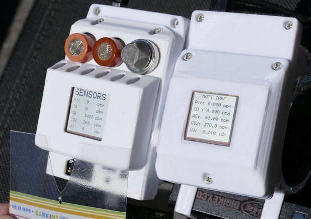

The third image shows the reading with a clear plastic sheet plus SPF30 sunscreen lotion. (It attenuates the UV Index to 3.11)
The sunscreen lotion was applied in a thin coating - hard to measure or describe the thickness of the coating, but is visible in the images on the right side of the plastic sheet.
If the readings are accurate the clear plastic reduced the UV Index by 0.91 and the sunscreen lotion with plastic sheet reduced it by 2.37.
Therefore the sunscreen lotion is contributing a reduction of 1.41 in the UV Index. I suspect the influence of visible light is making these differences smaller than true values, but even in this test sunscreen lotion significantly outperformed the plastic sheet.

    Another great demo of your incredible project!! Is there a way to test sunscreens to see how effective they are? Dale W
