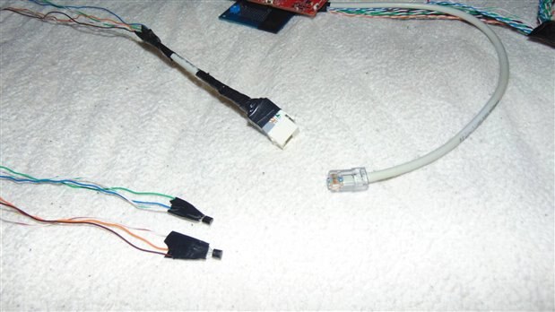

The wiring:
I ran CAT5e wires to the sensors. I found this was a nice light weight wire that was easy to use. As per DAB’s suggestion, I did a quick disconnect for the sensors in the legs (and the carbon fiber explained later). Since I am using CAT5e I wired in the usual male/female connector as my quick disconnect. It works very well as shown in the pictures:
I only had the leg sensors attached at this time, as you can see the four real weird temperatures and 2 correct ones!!

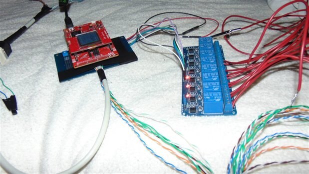

All hooked up!!

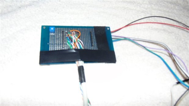

For a bit of a laugh, here is a picture of my home made board I through together that connects to the bottom of the MSP432. I did a PCB layout on AutoCAD, printed out an acid etch transfer and found I didn't have any blank PCB board left. No one in town had any either. I hope to get some in so I can make this a little more prettier.
