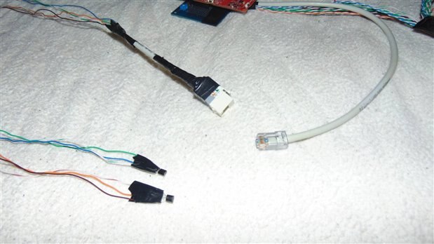

In this post, I will show how everything is coming together and works. After a frustrating 2 ½ weeks with my code not working with the temperature sensors I got that issue solved. I did post the solution but here it is again. There was an error with Energia compiling the code for the MSP432 Red. Before I knew this, an error showed up while compiling saying “analogRead” was not declared. This was odd but I declared it in my code and everything compiled but wouldn’t read the sensors. I searched the internet for solutions and finally found a forum where this issue was brought up. There was a reply saying that 1 week ago Energia released an update to correct this issue.... Really…. So, I did an update and everything compiled and ran exactly as it should have. Now that all is good I can continue with my project!!!
Code completed and working:

Hope it made sense!!
The suit:
All the carbon fiber is sewn into the suit (Thanks to my daughter Chrystal) and I have run tests for how many volts makes the carbon fiber heat up enough, but not to hot. For the legs and torso strips I need to have 14.8v to get me 52 deg C (125 deg F) which I found a very comfortable warmth. For the same result in the arms I required 7.4v, go figure, Chrystal made the carbon fiber ½ the length in the arms!! (Made my life easier). For fun, I ran the 14.8v to the arms to see how hot the carbon fiber would get, I disconnected the power when the temperature reached 86 deg C (187 deg F). Here again as suggested by DAB, I am doing a quick disconnect to all the carbon fiber as well as a manual over ride in case the computer should fail. Being a survival suit, the need to survive can’t rely solely on the computer working so I am putting over ride switches to each area for manual operation of the heater (this is not completed yet). Pictures below:
The wiring:
I ran CAT5e wires to the sensors. I found this was a nice light weight wire that was easy to use. As per DAB’s suggestion, I did a quick disconnect for the sensors in the legs (and the carbon fiber explained later). Since I am using CAT5e I wired in the usual male/female connector as my quick disconnect. It works very well as shown in the pictures:
I only had the leg sensors attached at this time, as you can see the four real weird temperatures and 2 correct ones!!
All hooked up!!
For a bit of a laugh, here is a picture of my home made board I through together that connects to the bottom of the MSP432. I did a PCB layout on AutoCAD, printed out an acid etch transfer and found I didn't have any blank PCB board left. No one in town had any either. I hope to get some in so I can make this a little more prettier.
