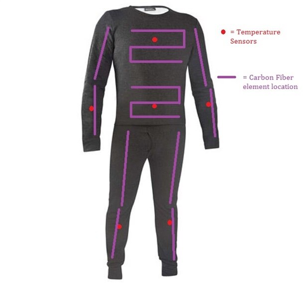

I will take full body thermal underwear and have it computer controlled to:
  • Monitor body temperature at 7 points and outside
    temperature
  • Display information on the LCD screen
  • Display warnings when your temperature drops
    below a set amount
  • Warm the part of you that is getting to cold

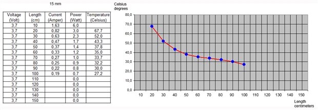

I have purchased (and now waiting to arrive) 8 meters of 15mm wide Carbon Fiber Tape. Carbon fiber tape is soft like silk and is 100%
washable. When electricity is put to it, it heats up like a heating blanket. The more electricity, the hotter it gets. Therefore the computer controlling
the carbon fiber will be very efficient for keeping the wearer warm.
Below are the carbon fiber specifications:
Specifications:
Material:
Carbon
  fiber 100%
Type:
Heating element
Resistance:
18±2
  Ohm/m ( 5.5±0.5 Ohm/ft )
Weight
5±0.5
  g/m (1.5±0.15 g/ft)
Width:
17±2 mm
  (0.67±0.08 in)
Thickness:
0.6±0.1
  mm (0.024±0.004 in)
Tensile
  strength
50±10 kg
Diagram of the suit
There will be sensors and carbon fiber elements in the back as well the head
