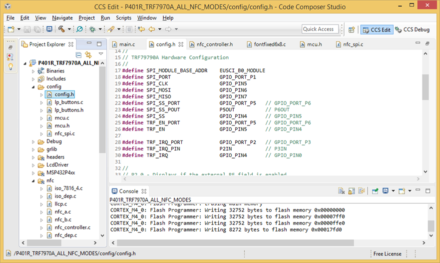

With my Hearing Guard System one of the features I plan to implement is to enable some sort of NFC to Bluetooth Connection Handover and since the Safe Sound kit came with a  DLP-7970ABPDLP-7970ABP Booster Pack it was a good opportunity to see about configuring this I had seen the post by Feng Yao with his Flooding early-warning Alarm Pack project which is a good intro to the  DLP-7970ABPDLP-7970ABP however in my project I want to implement NFC/RFID along with Bluetooth and the Sharp LCD but neither the  430BOOST-SHARP96430BOOST-SHARP96 LCD nor the  DLP-7970ABPDLP-7970ABP Booster Pack have stackable headers So basically you can only have one other the other on the MSP432 at a time To resolve this I changed some of the GPIO assignments for the  DLP-7970ABPDLP-7970ABP in the NFC example and was able to hack through the code to get some of the NFC data to display on the Sharp LCD

In order to get both the  DLP-7970ABPDLP-7970ABP and Sharp LCD Booster Pack to simultaneously on the MSP432 I moved the non SPI connections for the  DLP-7970ABPDLP-7970ABP to the inner headers on the MSP432 The basic SPI connections do not need to change but I did use a separate GPIO for the slave select
With the GPIO pins to use for the NFC/RFID Booster pack, edit the 'config.h' in the project 'config' folder.
The code change that I implemented in the config.h looks like this:
NOTE: The values in the comments are the before values.
// TRF79790A Hardware Configuration
#define SPI_MODULE_BASE_ADDR EUSCI_B0_MODULE
#define SPI_PORT GPIO_PORT_P1
#define SPI_CLK GPIO_PIN5
#define SPI_MOSI GPIO_PIN6
#define SPI_MISO GPIO_PIN7
#define SPI_SS_PORT GPIO_PORT_P5   // GPIO_PORT_P6
#define SPI_SS_POUT P5OUT          // P6OUT
#define SPI_SS GPIO_PIN4      // GPIO_PIN5
#define TRF_EN_PORT GPIO_PORT_P5   // GPIO_PORT_P6
#define TRF_EN GPIO_PIN5      // GPIO_PIN4
#define TRF_IRQ_PORT GPIO_PORT_P2   // GPIO_PORT_P3
#define TRF_IRQ_PIN P2IN           // P3IN
#define TRF_IRQ GPIO_PIN4      // GPIO_PIN0
// P2.0 - Displays if the external RF field is enabled.
#define NFC_RF_FIELD_LED_BIT BIT0
#define NFC_RF_FIELD_LED_POUT P2OUT
#define NFC_RF_FIELD_LED_DIR P2DIR
// P1.0 - Displays if the NFC host is connected to the controller.
#define NFC_HOST_LED_BIT BIT0
#define NFC_HOST_LED_POUT P1OUT
#define NFC_HOST_LED_DIR P1DIR
// P - Toggles during the RX of a NDEF packet via P2P.
#define NFC_RX_LED_BIT
#define NFC_RX_LED_POUT
#define NFC_RX_LED_PDIR
// P - Toggles during the TX of a NDEF packet via P2P.
#define NFC_TX_LED_BIT
#define NFC_TX_LED_POUT
#define NFC_TX_LED_PDIR
// LED1 P3.6 - Displays if the RW link is established.
#define NFC_RW_LED_BIT BIT7    // BIT6
#define NFC_RW_LED_POUT P3OUT
#define NFC_RW_LED_PDIR P3DIR
// LED2 P5.2 - Displays if the CE link is established.
#define NFC_P2P_LED_BIT BIT5    // BIT2
#define NFC_P2P_LED_POUT P3OUT   // P5OUT
#define NFC_P2P_LED_PDIR P3DIR   // P5DIR
// LED3 P5.0 - Displays if the P2P link is established.
#define NFC_CE_LED_BIT BIT1  // BIT0
#define NFC_CE_LED_POUT P5OUT
#define NFC_CE_LED_PDIR P5DIR
