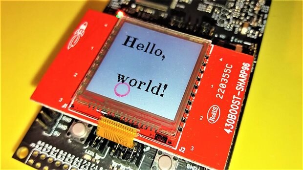

How to work with the Sharp LCD BoosterPack,  MSP432 LaunchPad and TI-RTOS.
There's (currently) no TI-RTOS driver or example for the Sharp LCD BoosterPack with the MSP432 LaunchPad. But someone fixed that for us...

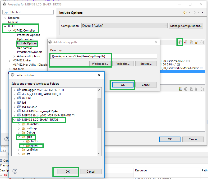

The start of that forum post contains a zip file. You'll find grlib and LcdDriver folders in BluHale path of that archive.
Copy these two to your project and add a new include entry that points to grlib/grlib.
And then add this include and rtos task (or just replace the existing heartBeatFxn() task of the empty example) to your project. Check my links below to learn how to start a TI-RTOS project if you don't have one ready.

The header of the rtos task initialises the LCD driver. The task's loop just flashes an LED to show that the RTOS lives.
There are 153 fonts available. Enjoy! Make something nice.

  • jomoenginer
    jomoenginer over 9 years ago in reply to jomoenginer
    Jan,
    Okay, I believe I have found the issue.  I was comparing the failing projects with the good projects I have and noticed the GrLib folder in the failing projects where shown as "GrLib" rather than "grlib" like in the passing projects.  Looking at the files that were used to import the "grlib" folder, I found the one with the "Grlib" folder came from the "BHLCD" directory the code that John Pocreva posted from the TI forum link you provide in you vid. If if i use the  LcdDriver and GrLib from the BHLCD folder the project fails to build.  But, if i user the LcdDriver and grlib from the BluHale folder, or the code you post, the project succeeds to build and load.  So, it's not a glitch in CCS but a glitch in the the user (me) with regards to the drivers that were pulled into the project.  I suppose this could be used as a FYI for anyone else that may run into this, but following your instruction and using your posted code should not show the build error.
