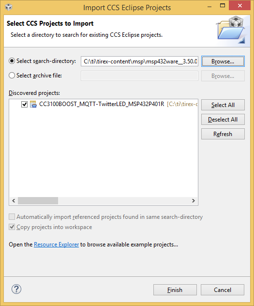

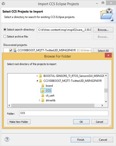

The first thing is to import the CC3100BOOST_MQTT_TwitterLED_MSP432_401R example from MSP432Ware.  I'm using CCS 6.2 and importing from Resource Explorer does not work all the time so I had to import the project directly from the appropriate folder.
On my system, this ended up at:
C:\ti\tirex-content\msp\msp432ware__3.50.00.02\examples\boards\MSP-EXP432P401R\MSP-EXP432P401R_Software_Examples\Firmware\Source\CC3100BOOST_MQTT-TwitterLED_MSP432P401R
From CCS, click on Project-> Import CCS Projects and navigate to the location of the example.
Once this is located and the 'OK' Button is clicked, the project should show up in the 'Discovered Projects' window.
Click 'Finish' and the project should be imported into CCS.

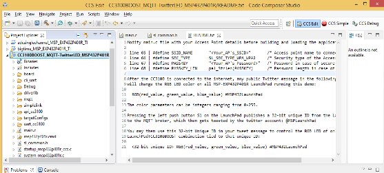

NOTE: There is README.txt with some instruction with regards to how to set-up the code for your particular environment.
In the 'main.c' file, locate the section of code that allows you to set the network parameters.
 * Values for below macros shall be modified per the access-point's (AP) properties
 * SimpleLink device will connect to following AP when the application is executed
//#define SSID_NAME       "<Your_AP's_SSID>"       /* Access point name to connect to. */
#define SSID_NAME       "YourSSID"       /* Access point name to connect to. */
#define SEC_TYPE        SL_SEC_TYPE_WPA_WPA2     /* Security type of the Access piont */
//#define PASSKEY         "<Your_AP's_Password>"   /* Password in case of secure AP */
#define PASSKEY         "WPA_WPA2_PASSWORD"   /* Password in case of secure AP */
#define PASSKEY_LEN     pal_Strlen(PASSKEY)      /* Password length in case of secure AP */
