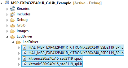

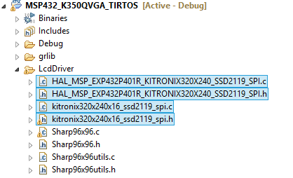

Then copy the following files from the MSP-EXP432P401RGrLibExample MSPWare LcdDriver->LcdDriver folder to the TI-RTOS empty project John Pocreva's LcdDriver folder.
From:
To:
You should be able to remove the Sharp LCD files since they are not used. or just copy the whole LcdDriver folder over instead.
