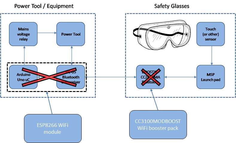

Short recap and choice of wireless modules
The idea: Power-tool/heavy equipment safety glasses that will not allow the tool to be switched on unless the operator is actually wearing them. This will be accomplished with the help of various sensors that will be in charge of the "am-I-being-worn-by-the-operator" part and a wireless link that will transfer the information to the base unit. If you recall,the original idea as depicted in the introduction blog was to use Bluetooth transceivers for the wireless communication. I've decided, however, to implement the link using a Wi-Fi connection based around the ESP8266 Wi-Fi module and the CC3100 booster pack. Since the ESP8266 has a built-in uController, it can be directly connected to the mains voltage relay so the design can be a bit simpler and more compact. A possible downside of the Wi-Fi approach is the higher power consumption as compared to Bluetooth (especially Bluetooth Low Energy), a critical parameter for wearable applications. However, in the current case there is no need for continuous Wi-Fi opperation. For example, the CC3100 can be switched on once a minute for a few seconds, report back and go back to standby mode. Of course, a more in depth examination of the power consumption is required but I believe that switching to Wi-Fi will not violate the power consumption requirements.

1) Configure the ESP8266 as an AP (access point) and as a server. Using the AP configuration will free the WiFi modules from having to connect to a wireless router, which may not be available in a typical working/industrial environment. In the AP mode, the ESP8266 will create its own wireless network which the CC3100 will be able to connect to.

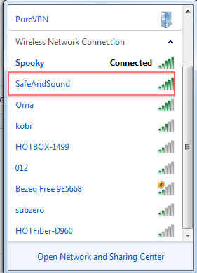

  • Once you download the code to the board you will see that a "SafeAndSound" wireless network become available. Connect to the network using the password listed in the code above.

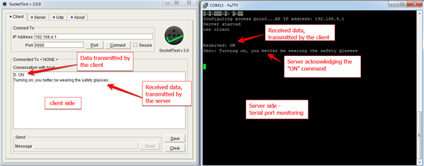

  • Open a serial monitor and examine the output. The IP address of the access point should appear.
  • Use a tcp client (like PuTTy or SocketTest) to connect to the above IP address on port number 9999. Once connected, send a command and examine the response.
It Works! We sent the "ON" command from the client to the server. The server acknowledged the command by printing a text to its serial port and transmitting the same text back to the client.
