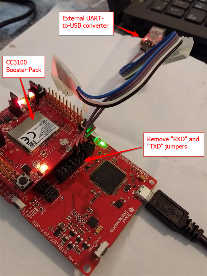

In spite of all its benefits, I ran into a very annoying issue with Energia: for the life of me, I couldn't get the on-board serial port working. As you probably know the Launchpad has an on-board serial-to-usb emulator that is connected to one of the MSP432 UART pins. This is extremely convenient for interface and debug purposes. I've tried installing and uninstalling the drivers multiple times and on multiple computers. Nothing seemed to work. The weird thing is that when the MSP was programmed using Code Composer the serial port worked fine, but when programmed using Energia it simply wouldn't work. Very frustrating.
Since the serial port is critical for developing with Energia (no debugging) I've finally decided to try and use an external UART-to-USB converter. And what do you know? Worked like a charm.
I hope you don't run into this issue. But if you do, simply disconnect the two jumpers labeled: "RXD" and "TXD" and connect your external converter instead.
So, in summary, if you run into a problem with the serial port while working with the MSP423 Launchpad and Energia, follow these steps:
  • Install Energia (don't forget to install the support for the MSP432 through the Board Manager).
  • Remove the two jumper labeled: "RXD" and "TXD".
  • Connect an external UART-to-USB converter to the "RXD" and "TXD" pins (on the MSP432 side).
  • Finally, connect the CC3100 booster pack to the Launchpad. Connect the Launchpad and booster pack to the PC via the micro-usb connectors (note that the micro-usb connector on the CC3100 is used as only to power the booster-pack. Although I've found it to work even when powered from the Launchpad, it is recommended to power the WiFi booster-pack directly from the USB).

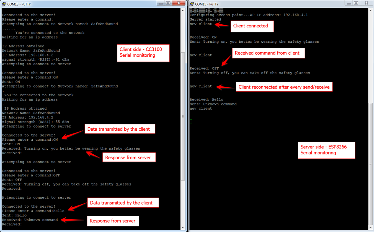

2) Testing it out
Ok, finally we are ready to test it all out:
  • Compile the sketch and download the code to the launchpad.
  • Connect the UART-to-USB and the previously programmed ESP8266.
  • Open two serial ports: one for the client, one for the server.
  • Make sure that client has connected successfully and now we can start transmitting and receiving information.
3) Summary
  • We have successfully established a direct WiFi link between the Launchpad+CC3100 and the ESP8266.
  • The safety glasses will be equipped with the CC3100 and the power tool with the ESP8266. Depending on the sensor readings, the CC3100 will transmit the words "ON" or "OFF" and ESP8266 will switch the tool on or off accordingly.
