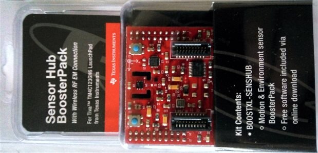

Unfortunately our local dealer did not have the BOOSTXL-SENSORS module so I bought Sensor Hub BoosterPack It's not quite compatible with the  MSP-EXP432P401RMSP-EXP432P401R but since all the sensors of this board are connected via the I2C interface I'll make an adapter for it
Sensors BoosterPack Plug-In ModuleSensor Hub BoosterPack
TI OPT3001 Ambient light sensorIntersil ISL29023 ambient and infrared light sensor
TI TMP007 Infrared temperature sensorTI TMP006 non-contact infrared temperature sensor
Bosch BMI160 Inertial Measurement Unit (IMU) sensor –
accelerometer and gyroscope
InvenSense MPU-9150: 9-axis MEMS motion tracking
3-axis gyro
3-axis accelerometer
3-axis compass
Bosch BMM150 Magnetometer
Bosch BME280 Environmental sensor -
pressure, ambient temperature and humidity
Bosch Sensortec BMP180 pressure sensor
Sensirion SHT21 humidity and ambient temperature sensor
