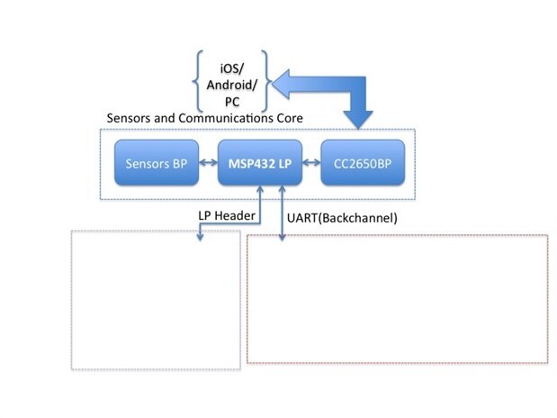

My initial intention was to create a safety jacket for industrial workers, however as my understanding of the components evolved, so did my design. Firstly, my initial design included a CC1310 which works on a frequency band which is not allowed in my country which puts a bit of a dent in my plan. The alternative is to use the BLE connectivity for the IoT-ivity.    Next the BQ25570 and superCap combination does not have enough juice to run the complete system, hence, an alternative power source needs to be deployed. Lastly, I am not a professional programmer hence I would have to depend on copy-paste and a lot of trial and error to get things to work.
My final design is hence divided into three sub-sections as described below.
I will be explaining these blocks one at a time so as to provide sufficient detail and place for discussion. Lets get started.
The First Module: The Sensors and Communication Core
One of the requirements of this design challenge is the inclusion of the MSP432 Launchpad and in my case, we need to add the CC2650 Booster Pack to the mix. The Sensors Booster Pack provides all necessary parameter for this case and this data is sent wirelessly to the Android/iOS or PC which can then send the data to the cloud and other data sinks.

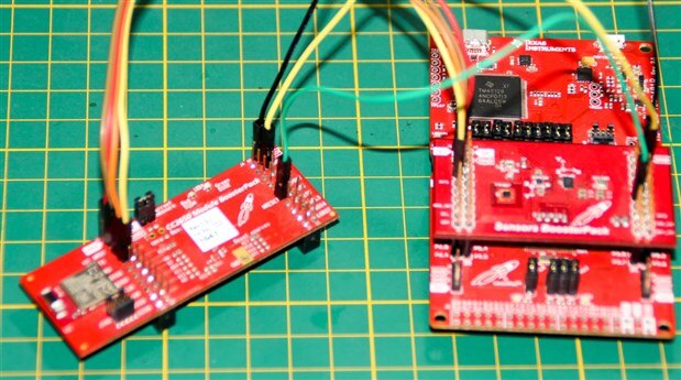

c. Simple Network Processor API and the CC2650 Booster Pack
The BLE code was the hardest part to work with and the most rewarding in terms of the learning experience. The CC2650 module has a processor inside it and can function as a standalone network processor, however in this application, it is required to serve as a slave device to the MSP432 such that it can be replaced or even upgraded to the newer Bluetooth 5.0 devices. The communication happens over a UART and an additional three pins are required to make things work.
The CC2650 in our case has the UART slave firmware loaded, however, SPI can be chosen as an alternative to UART requiring a simple firmware upgrade. Once the firmware is loaded, Project Zero from the MSP432 SDK - Bluetooth Plugin resources can help expedite the process of setting up your first project.

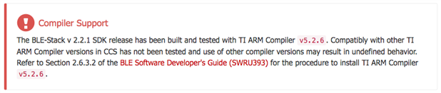

Unfortunately, the generated code is no longer compatible with the newer BLE SDK plugin.
I wanted to do something with the newer compiler so the only option is to do a trail and error of the produced code. My requirement is to advertise the services since my NodeJS app likes to get that info off the bat. A better understanding of the BLE Frame and packets is necessary and I found the explanation at http://www.argenox.com/a-ble-advertising-primer/ very useful. The docs at https://docs.mbed.com/docs/ble-intros/en/latest/Advanced/CustomGAP/ are very useful.
By editing the project_zero.c and relevant profile.c files, the desired result can be achieved. Long story short, I was able to remove some manufacturer information and replace it with service information. There are only 31-bytes available for the Device Name, Flags, URIs and service data so the choice was a difficult one. All UUIDs were shrunk down to 32-Bits so that everything fits in. Instead of a tutorial, I am sharing the code on github for anyone interested in following along.
The result is the ability to get data from the sensors over BLE and an understanding of how to use the SNP better. For a TI tutorial on the subject that is a bit out of date, please visit http://software-dl.ti.com/lprf/simplelink_academy/modules/ble_01_bds/ble_01_bds.html Another must visit is http://software-dl.ti.com/lprf/simplelink_academy/overview.html

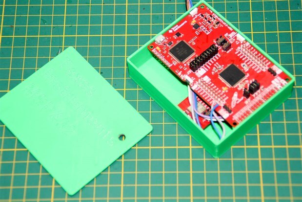

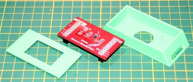

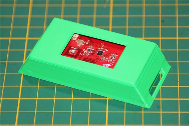

This is a wearables challenge and my target is a jacket which leave a lot of room for imagination. I chose a small box like enclosure which will be placed in the pocket of the jacket. The enclosure was design in Autodesk Fusion 360 and 3D printed on a Cel Robox.
The result is a tight box with the headers exposed which will be used in module 3 of my design. The Sensors booster pack has been trimmed and enclosed in a box that can be fitted to the jacket. I2C lines will run down inside the jacket to where the core module is.
Conclusion
I have started laying out the final submission starting with module one which has the MSP432, the sensors booster packs and the CC2650 with a lot of custom code. With the enclosure complete and handed off to my better half, the final product should be something to look forward to. Getting there...

    Wise words. Unfortunately TI's Cloud CCS does the upgrade automatically and there could possibly be a setting somewhere to take the compiler version down a minor rev. My issue was that the discovery of…

    Wise words. Unfortunately TI's Cloud CCS does the upgrade automatically and there could possibly be a setting somewhere to take the compiler version down a minor rev. My issue was that the discovery of the dependencies came too late and like I said, the information is quite scattered due to the large portfolio.
    TI in making a combined API created a monster that takes a while to tame. image
    DAB over 9 years ago
    Nice update.
    I have found it useful to lock in tool versions for projects so that we did not run into update problems like you experienced with the BLE.
    It is always better to use a version of software you know than take a chance on an update that might do more TO YOU than it does For You.
