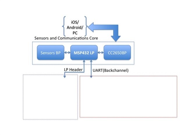

My final design is hence divided into three sub-sections as described below.
I will be explaining these blocks one at a time so as to provide sufficient detail and place for discussion. Lets get started.
The First Module: The Sensors and Communication Core
One of the requirements of this design challenge is the inclusion of the MSP432 Launchpad and in my case, we need to add the CC2650 Booster Pack to the mix. The Sensors Booster Pack provides all necessary parameter for this case and this data is sent wirelessly to the Android/iOS or PC which can then send the data to the cloud and other data sinks.

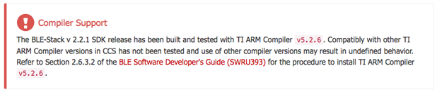

TI has been hard at work releasing the new version of TI RTOS and I did a video demonstrating the sample code. I had shown how the demo code for the Sensors BP did not work at all (https://www.element14.com/community/community/design-challenges/texas-instruments-safe-sound-wearables-design-challenge/blog/2017/04/10/safe-sound-safety-jacket-for-the-tolling-industry-7-cloud-ccs-and-sample-code-issues) and I took it as an opportunity to learn about coding drivers.

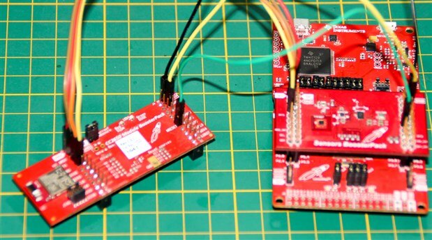

The BLE code was the hardest part to work with and the most rewarding in terms of the learning experience. The CC2650 module has a processor inside it and can function as a standalone network processor, however in this application, it is required to serve as a slave device to the MSP432 such that it can be replaced or even upgraded to the newer Bluetooth 5.0 devices. The communication happens over a UART and an additional three pins are required to make things work.
The CC2650 in our case has the UART slave firmware loaded, however, SPI can be chosen as an alternative to UART requiring a simple firmware upgrade. Once the firmware is loaded, Project Zero from the MSP432 SDK - Bluetooth Plugin resources can help expedite the process of setting up your first project.

Unfortunately, the generated code is no longer compatible with the newer BLE SDK plugin.
I wanted to do something with the newer compiler so the only option is to do a trail and error of the produced code. My requirement is to advertise the services since my NodeJS app likes to get that info off the bat. A better understanding of the BLE Frame and packets is necessary and I found the explanation at http://www.argenox.com/a-ble-advertising-primer/ very useful. The docs at https://docs.mbed.com/docs/ble-intros/en/latest/Advanced/CustomGAP/ are very useful.

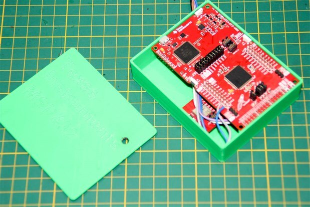

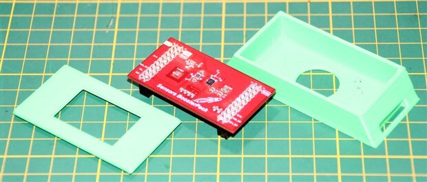

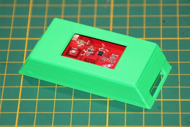

This is a wearables challenge and my target is a jacket which leave a lot of room for imagination. I chose a small box like enclosure which will be placed in the pocket of the jacket. The enclosure was design in Autodesk Fusion 360 and 3D printed on a Cel Robox.
The result is a tight box with the headers exposed which will be used in module 3 of my design. The Sensors booster pack has been trimmed and enclosed in a box that can be fitted to the jacket. I2C lines will run down inside the jacket to where the core module is.
