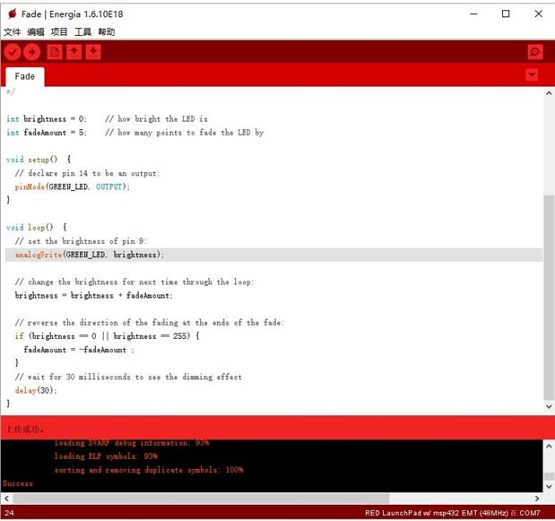

2. First I test fade.ino for Launch Pad MSP432401R as follows,
Arduino -like code shows as,
int brightness = 0;    // how bright the LED is
int fadeAmount = 5;    // how many points to fade the LED by
void setup()  {
  // declare pin 14 to be an output:
  pinMode(GREEN_LED, OUTPUT);
void loop()  {
  // set the brightness of pin 9:
  analogWrite(GREEN_LED, brightness);
  // change the brightness for next time through the loop:
  brightness = brightness + fadeAmount;
  // reverse the direction of the fading at the ends of the fade:
  if (brightness == 0 || brightness == 255) {
    fadeAmount = -fadeAmount ;
  // wait for 30 milliseconds to see the dimming effect
  delay(30);
The board support for MSP432 shall be installed for board-manager after  installation.

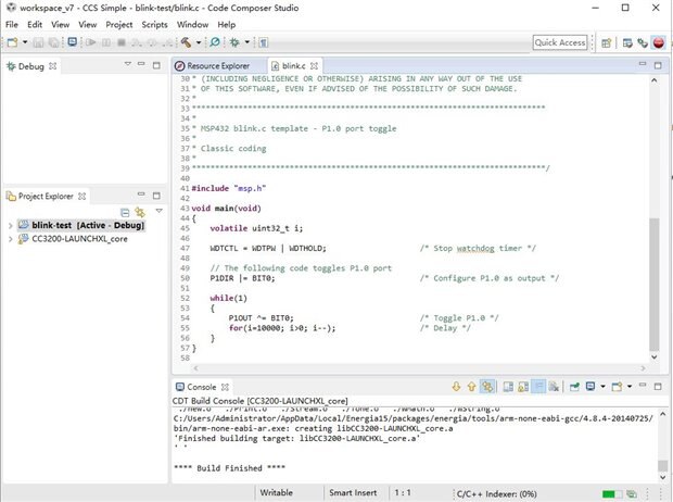

2. Then ,same blink test for CCS7.x

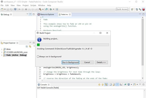

It is OK to use energia in CCS environment like,
the binary file fade.bin can be built, which can use uniflash to put them into the Flash of MSP432.
Of course, standard CCS UI can be as follows,

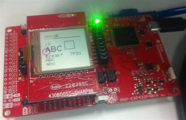

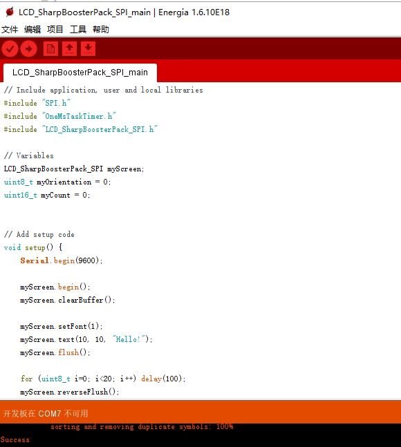

Now that for LCD boostPack, try the following sketch with "Hello." and characters shown.
    DAB over 9 years ago +1
    Nice post. Any reason why the picture does not show the display with HELLO? DAB
  • fyaocn
    fyaocn over 9 years ago +1
    HELLO is the first part of the program and flashed away by following screenshot, I miss that part when I use screenshot. This is demo project and can be reached by any one with energia. It is a real bug…
