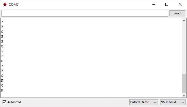

I had this android app written using MITapp Inventor long ago for some other purpose, but came handy for testing these modules. There are plenty of Apps like this in the store.
and Test results were both the modules worked.

This data for now is the one I'm entering in the SerialMonitor of Energia IDE but this actually will be the data collected from the Sensors in the upcoming blog.
Sent a "Hello" from LaunchPad to Edison
Voila!
