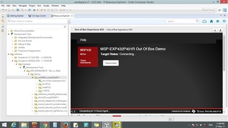

GUI - [could not connect in CCS v7.1.0]
This example code comes with a GUI that communicates with the Launchpad through serial COM port. Blinking speed and color can be selected from the GUI.
However, I could program and debug this example code from CCS v7.1.0 and the GUI gets started, but could not connect to the launchpad.

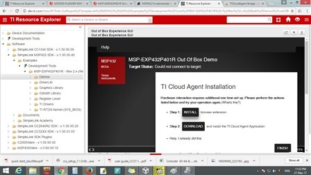

So, I tried to check out the online resource explorer and found that the GUI runs smoothly on both Chrome and Mozilla after installing the TI Cloud Agent addon.
CCS v7.1.0 shows 'connecting' but could not connect to Launchpad   Resource Explorer runs the GUI on Chrome and asks for TI Cloud Agent Installation

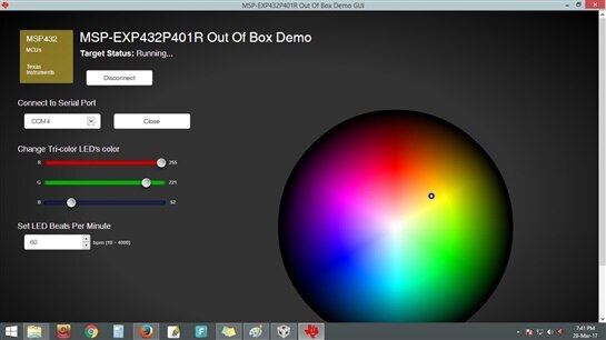

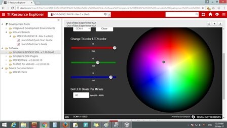

GUI can connect to the device after installing TI Cloud Agent on Chrome   GUI runs smoothly on Chrome to change blinking speed and color
Later on, I tried another approach to run the GUI offline from my desktop. I installed the 'software example' bundle from the product page of TI and found a standalone executable file for the GUI. This time it runs without any problem. However, I'll try to figure out whats wrong with CCS v7.1.0 later on.

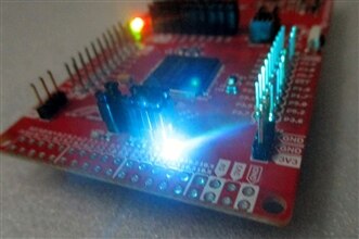

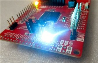

Example code:
03 - PWMLED
Description -
This example code generates a PWM on the P2.0 pin where the RGB LED [red] is connected. The duty cycle of the PWM signal gradually increase and decrease within a time period.
With respect to that the brightness of the LED also increases and decreases gradually.
My aim for trying this code was to check out the EnergyTrace Technology of the Launchpad and CCS.
Brightness of the LED changes with the duty cycle of the PWM signal

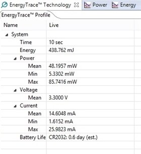

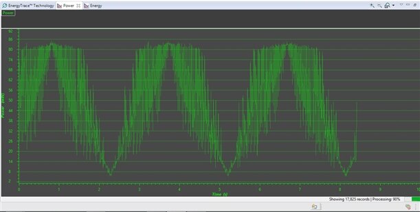

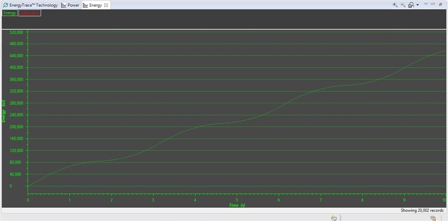

Energy Trace:
MSP-EXP432P401RMSP-EXP432P401Rlaunchpad supports Real-time power consumption reading and the CCCS v7.1.0 has nice GUI to view those traces I tried PWMLED example code mentioned above to check out this function As the brightness of the LED increases and decreases the power traces follow a gradual increment and decrements This tool generates an assumption of battery life based on the energy consumption too
overview on energy consumption [10sec]                                       Power trace - real time
energy trace - 10 sec long

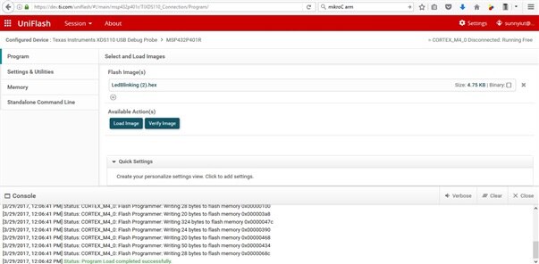

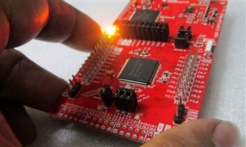

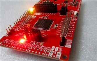

MikroC Pro for ARM and UNI FLASH:
I am a big fan of Mikroelektronika MikroC compilers. They have recently added support for MSP432 microcontrollers in their MikroC Pro for ARM compiler.
Therefore, I liked to go for a test drive with this compiler. To download the hex into the MSP432P401R through the launchpad programmer, I used TI's web based programmer UNI FLASH.
My experience is pretty good. I made a simple program to blink both LED1 and LED2 with 300ms delay. UNI FLASH connects to the launchpad smoothly and load the hex with a very simple GUI.
void main() {
  GPIO_Digital_Output(&DIO_P1IN, _GPIO_PINMASK_0 | _GPIO_PINMASK_1);
  GPIO_Digital_Output(&DIO_P2IN, _GPIO_PINMASK_0 | _GPIO_PINMASK_1);
  DIO_P1OUT = 0;
  DIO_P2OUT = 0;
  DIO_P1OUT.B0 = 0;
  DIO_P2OUT.B0 = 0;
  while (1) {
    DIO_P1OUT.B0 = 1;
    Delay_ms(300);
    DIO_P2OUT.B0 = 1;
    Delay_ms(300);
    DIO_P1OUT.B0 = 0;
    Delay_ms(300);
    DIO_P2OUT.B0 = 0;
    Delay_ms(300);
