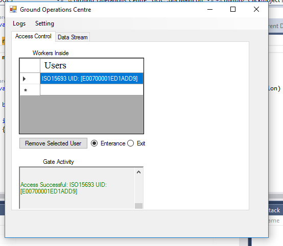

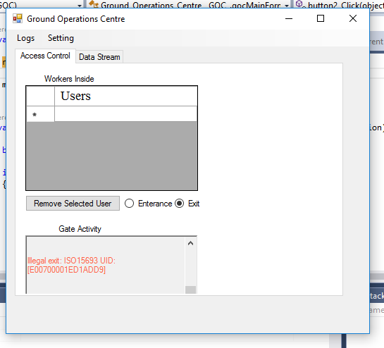

Deadline is closing and I need to be faster. This week, I created a circuit board and removed the breadboard. The original plan was to add methane sensor but I couldn't find any portable version for the helmet. Usual gas sensors have a heating element which is dangerous for the mining areas so I skipped that part. Below the video, you can see the demonstration of the smart helmet.
Some screenshots from the Ground Operations Centre program.
The raw data structure is ##*temperature*accelerometer interrupt*accelerometer data* analogue input*-- . For instance, accelerometer interrupt area shows 131 when there is no interrupt, 139 for the inactivity alarm, and 147 for the freefall alarm. Next, I will modify the user interface and show this data as a user-friendly manner.
The Ground Operations Centre can also track the who is accessing the mine area. The NFC tag allows miner who has the smart helmet but if the same tag try to access/exit twice it will give warning as shown below.
