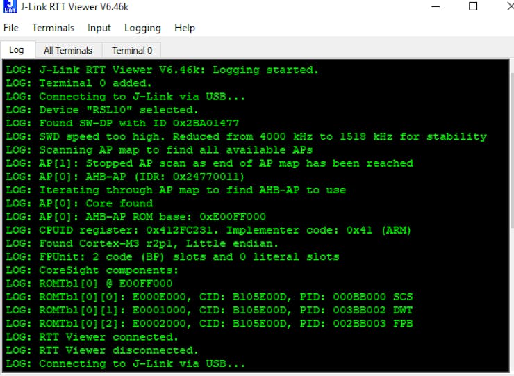

Step 1: Let's build
Required parts for building this project is mentioned above. The main one is the SL-10-SENSE-GEVK module along with the debugger. You'll need to program and test various things.
After installing eclipse based ON-SEMI IDE and support packages you can test basic sensor with deep sleep and get some data on the phone. For these, you can refer to very nicely written getting started guide.

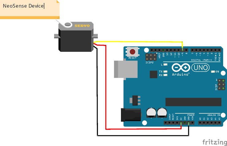

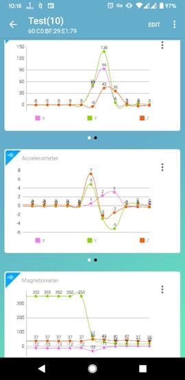

Basically our requirement is to get the data of respiration rate per minute. How do we do it is the question. With careful observation, there is a small change in the accelerometer Z-axis motion whenever the baby's chest moves up and down while breathing. According to the datasheet of the accelerometer and gyroscope sensor BHI160 we will get a precise reading of accelertion values and orientation values with very less false positives i.e less than 9 in 5 mins of continuous reading

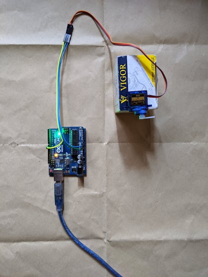

To prove this and calibrate the motion I made a simple setup with servo motor doing the action for us in a very slow manner. With the help of this, we can check whether the number of breaths per minute is above or below the threshold value.
Step 3: Calibration and testing

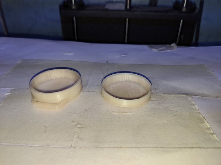

I designed and 3d printed housing for the RSL10 device which can also calculate the body temperature using a BMP680 temperature sensor. In order to increase the sensitivity of the IC, I have attached a metal tape and a connecting wire.
For the design default 3D builder software on windows 10. You can use Fusion 36) or solid works etc.

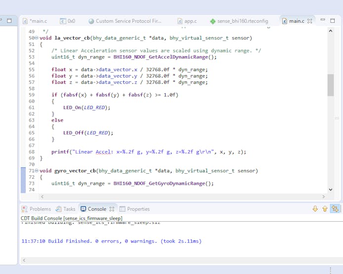

Step 4: Writing the code for the RSL-10-SENSE-GEVK
Since we want to save the power we can turn off unwanted devices and use only required sensors. Accelerometer and temperature sensor.
struct SwTimer tim1; struct SwTimer_Duration tim_dur1; SwTimer_Initialize(&tim1); SwTimer_Start(&tim1); SwTimer_GetElapsed(&tim1, &tim_dur1); if (fabsf(z) >  2.0f) { k++; if (k > 30) { k=0; } } if ( k < 18 && tim_dur1.seconds > 60 ) { printf("Breath rate is too low"); LED_On(LED_RED); LED_On(PIN_GIO_SPARE); } SwTimer_Remove(&tim1);
Here time is used to determine the rate of breathing
The basic logic here is to detect whether the breathing rate is falling below the threshold i.e 18 breaths per minute. An as soon as that happens red LED will blink to indicate that. Temperature monitoring is done as well to know the trend of breathing over temperature changes.

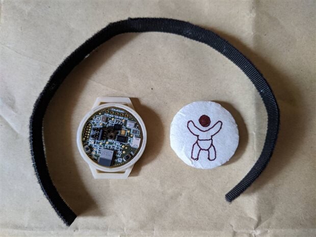

Step 5: Fastening and testing :
If the baby is covered in surgical grade protective cloths, one can directly attach the device on the chest part of the baby using velcro strip or when the baby is naked one can use surgical band-aid tapes to secure the sensor. The same sensor can be worn by the mother around her shoulder for kangaroo mother care. Which records the temperature of mother and baby to monitor their health,
In developing nations in Africa and Asia, this device can help in remote locations where there is a lack of connectivity and resources such as hospitals, ventilators and incubators in the case of premature birth.

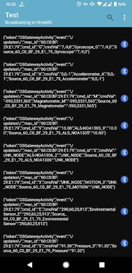

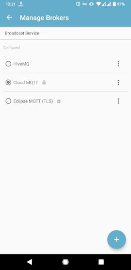

Step 6: Connecting it to cloud

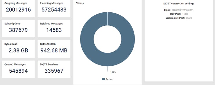

In the On Semiconductor app itself, there's MQTT broker installed one can directly use their phone as IoT gateway and push the data to the cloud. If you are interested you can even set up your own generic MQTT broker in the app and
Hive MQ has open-source service where one can send the data to their MQTT server. It supports the latest MQTT 3.1 also. Here's the detailed description.
Here I'm adding my broker.
Testing the sending of data:
