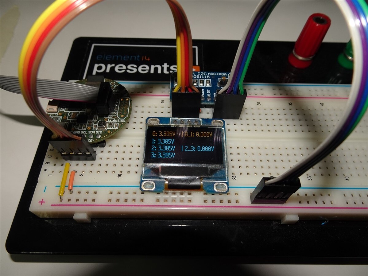

Being an ultra low power device OLED display is perfect combo for RSL10 to display necessary information. C version of well know U8G2 library is used to interface this 0.96" OLED display with On-Semi RSL10-Sense-Gevk board.
// U8G2 display structure
static u8g2_t u8g2;
// u8x8_byte_rsl10_hw_i2c and u8x8_gpio_and_delay are hardware related functions.
u8g2_Setup_ssd1306_i2c_128x64_noname_1(&u8g2, U8G2_R0, u8x8_byte_rsl10_hw_i2c, u8x8_gpio_and_delay);
u8g2_InitDisplay(&u8g2);
u8g2_ClearDisplay(&u8g2);
u8g2_SetFont(&u8g2,u8g2_font_guildenstern_nbp_t_all);//set current font
// Code to display string
u8g2_FirstPage(&u8g2);
do {
     u8g2_DrawStr(&u8g2, 60, 60, temp);//write string - you set coordinates and string
} while (u8g2_NextPage(&u8g2));
DEMO:
ADS1115 data is being displayed on 0.96" Oled display to test and verify the u8g2 display library.
USEFUL LINKS:
U8G2 C source: https://github.com/olikraus/u8g2/tree/master/csrc
Helpful details: https://github.com/olikraus/u8g2/wiki/Porting-to-new-MCU-platform

    Yes these are very useful and low power display modules. You only need to write two hardware related functions and this graphics library can be used with any microcontroller.

    Mahmood, Nice display. I have purchased some similar ones for my robots so I am very interested in what you have done. The links seem very useful. Dubbie

    Very cool display : ) Nice to see it functioning with the RSL10. I'll have to get a couple of these for a project or two.
