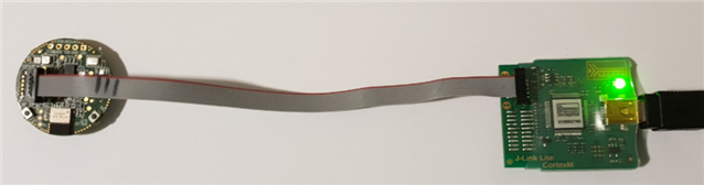

Unboxing

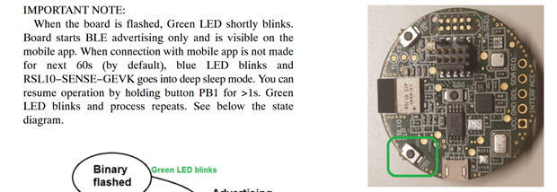

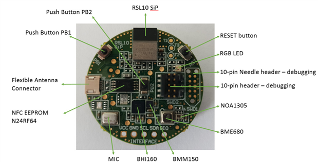

i get the RSL10−SENSE−DB−GEVK debug version that comes with the Segger JLink debugger
a good place to start up is at https://www.onsemi.com/products/connectivity/wireless-rf-transceivers/rsl10
to setup, we can follow https://www.onsemi.com/pub/Collateral/EVBUM2614-D.PDF ,
orientation of the cable

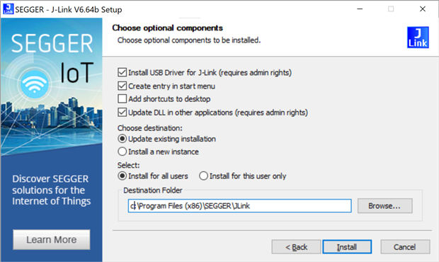

the software to install is here https://www.segger.com/downloads/jlink/#J-LinkSoftwareAndDocumentationPack
note: if one upgrade, just need to overwrite by choosing update existing installation

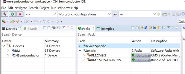

install RSL10 IDE
Download CMSIS pack
for RSL10 https://www.onsemi.com/PowerSolutions/product.do?id=RSL10
Install B-IDK https://www.onsemi.com/pub/Collateral/ONSEMICONDUCTOR.BDK.1.13.2.PACK.PACK
ARM CMSIS 5.5 and above https://github.com/ARM-software/CMSIS_5/releases
ARM CMSIS FreeRTOS https://github.com/ARM-software/CMSIS-FreeRTOS/releases

add your installation to system path
my installation is C:\Program Files (x86)\SEGGER\JLink

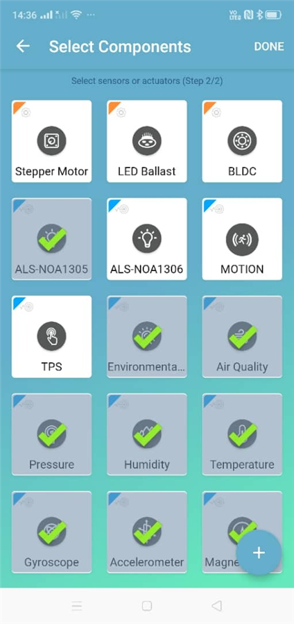

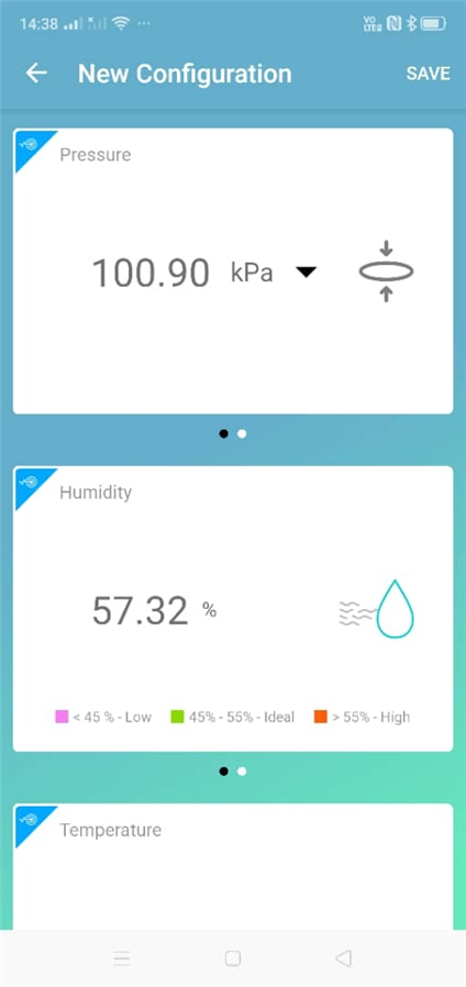

Android App
i use android app of the RSL10
first press the button and connect the device with Android
once connected, select the sensors and click done
