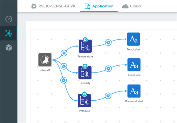

There is an easy-to-follow tutorial for the RSL10-SENSE-DB-GEVK on the Atmosphere IoT website (“Getting Started with RSL10-SENSE-GEVK”). That shows you how to get data from (most of) the onboard sensors, configure a mobile app to display the data in real time and also send the data to the Atmosphere IoT cloud (which then makes it available to be viewed from any Internet-enabled device). To view the cloud data remotely (e.g. on your PC), you can create a “Dashboard” to display your data on a browser.
I did find a few bugs in the Atmosphere IoT app software when it comes to configuring the Dashboard. Overall, the iOS app works well (as long as the device is charging). Like the Sense and Control app, I couldn't get this app to work reliably with my Android phone. On either version of the app, it is better to configure the web dashboard on your PC (or Mac) because the various menus and options don’t render properly on all mobile screens and I found I got stuck on a screen that I couldn’t get out of a few times.

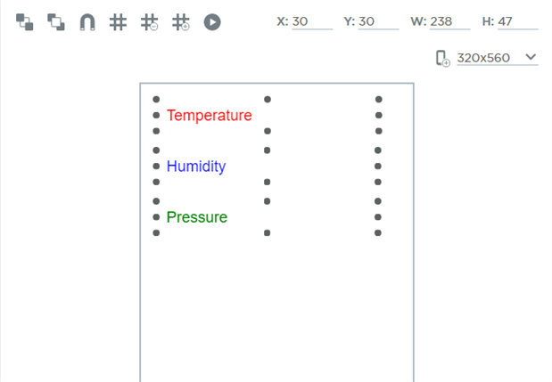

The screenshot below shows how the app screen is configured in the Atmosphere IoT IDE. This is what you get if you just follow the tutorial, but it wouldn't be hard to make it look prettier.

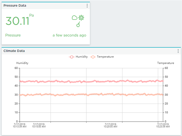

The next screenshot (taken from the tutorial) is of a dashboard, showing how the data would look in the Atmosphere cloud.
In summary, I am pretty sure that I could get the RSL10-SENSE-DB-GEV to stream data via my iPad to the cloud as long as I plugged a small USB powerbank into the iPad to stop the lockscreen from kicking in. This is always assuming that the iPad has a 4G signal wherever I am running (living in a big city more or less guarantees that). I prefer the Atmosphere IoT IDE as there is very little to install (just the Segger J-Link software and a little "helper" app to link the Atmosphere cloud compiler to the Segger software that flashes the code).

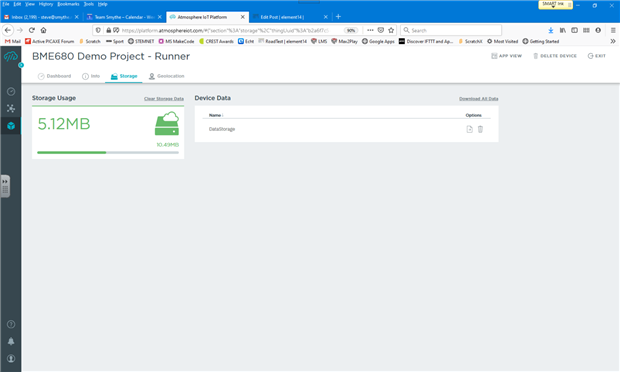

I could see two ways of getting the RSL10 data out of the cloud and into Golden Cheetah. One would be direct integration with the cloud data and the other would be to download the cloud data into Excel, manipulate it and then import it into Golden Cheetah. I haven't really looked at directly integrating Golden Cheetah with Atmosphere IoT yet but I know that Golden Cheetah has a cloud services API and can pull in data from Strava - a popular cloud-based training log software aimed at runners and cyclists. I know that you can integrate the Sense and Control app with your own choice of cloud services provider, so that would probably swing the decision in favour of Sense and Control if I decide to go the cloud integration route (the preferred option).
The second way (download then import) would be relatively easy, but time-consuming. There's an option in the Atmosphere IoT platform to do just that.
Then, in Golden Cheetah you would import the data from the *.csv file. I think that would swing the decision in favour of Atmosphere, rather than Sense and Control if I can't get the cloud integration to work.
