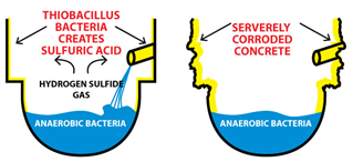

1) Predicting the Next deadly Manhole EXPLOSION...
The random hazards associated to smoking, flaming and exploding manholes are a result from decrepit wiring of underground transmission lines, which can lead to sparks and further in contact with underground toxic-gases, result to 'next big-bang'(mostly). Still, the system lacks a clean method of knowing where or when the next outburst would occur; repairs are commenced only after a manhole-growls(ironically).

2) Effect of Temperature & Humidity changes on sewage-bionic life & Infrastructure
Temperature plays an important role in processes that affect the infrastructure and operation of wastewater works. Based on data obtained from wet weather conditions and cold periods, It was determined that a decrease of one degree Celsius in the liquid leads to a 10% reduction of the maximum specific net growth rate of nitrifying microorganisms. In sewer systems, high temperature accelerates processes involved in the sulfur cycle affecting the long term corrosion of pipes as well as the production of unpleasant odors and flammable gases. A study revealed that a change of 5 ℃ (from 20 to 25 ℃) increased the sulfide oxidation by 15%.

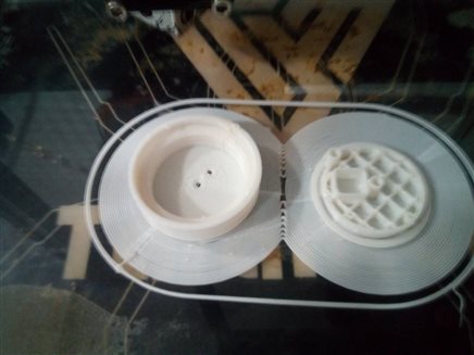

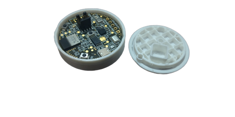

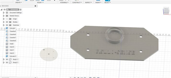

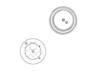

An enclosure for RSL10Sense Board has been designed through Fusion360 and 3DPrinted. Quick references were obtained from the Board Resources (3DPDF) document for the RSL10Board, provided by the ONSemi but still conditions were tough to export the concerned 3D PCB file, even after utilizing Tetra4D converter. Hence, I went on to 'scratch' the enclosure from datum. [I'm Feeling Lucky]; OnSemi provided the necessary gerber for RSL10Sense, which was further imported into Altium Designer-19, and hence I was able to export the 3D PCB (top-mask and dimension layer)into the CAD program.
Using the 'force'(Vernier Calipers), and compensating it for the tolerances of ABS material, I was able to build an enclosure for RSL10Sense in one shot.

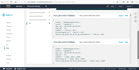

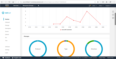

Got few shots from AWS, during the early trials(the .json export feature is quite helpful, though the acquisition rate for dashboard update is at 'snail's pace' vs. IBM's IoT Cloud)
Similar, to AWS one can create custom boards under IBM Watson IoT Cloud "Boards Manager", and create custom Gauge, Time-stamped data insights, plotting on graph, etc.

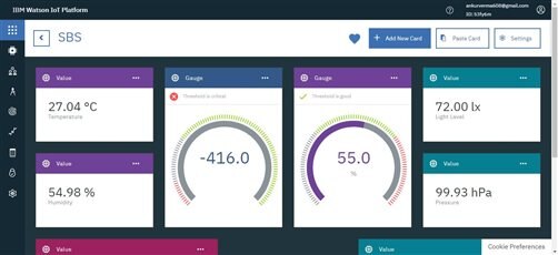

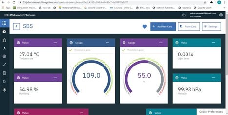

Finally publishing the data on IBM Watson IoT Cloud
                                                           Dash#1                                                                                                                            Dash#2
                                                              Dash#3                                                                                                                           Dash#4
(Manual labeling on trigger events has been performed, still need a large data-set for training a Classifier for ML based approach.)

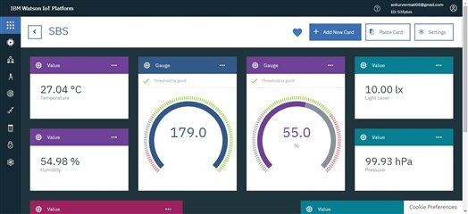

The above pictures are obtained from IBM Watson IoT Cloud, which show the sense-hub;
The first dashboard image was captured under normal sensor working condition, with every other parameter like internal temperature, humidity and lux-levels. [Refer: dash#1]
Light-intensity data from 0 - 10lx under low light condition, and value 72lx(has been simulated for low intensity flame-condition). Moreover, values upto 400lx have been observed during the tests done with LPG burners. Also the geomagnetic sensor data has been depicted through gauge and pre-defined threshold status, weak lodestone disks report for values (179-300), while tests with neodymium reached peak value of (850); though it disrupts the calibration routine of sensor(resulting in high inacuuracies in orientation values), still works for our job. [Refer: dash#2 & dash#4]

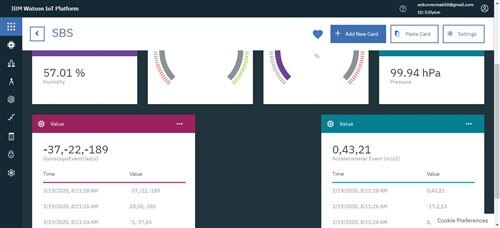

The accelerometer & gyroscope values are time-stamped and recorded for post-processing application. Combining the IMU data through Classifier Learner App (Matlab) and Tesseract, one can predict the structural integrity of cover, by using the transfer-learning approach, even low dataset produces accurate results. [Refer: dash#3]
