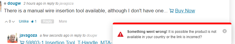

    dougw over 4 years ago in reply to robogary
    I do set up carefully, with markers to cue me about what the field of view envelope is, to try and get it all in one take, but inevitably all those problems you mentioned, and more, crop up. I just keep rolling, hoping I can cut out the crappy sections. If I know there was a problem I will redo it (if possible) without stopping the camera. The camera definitely can have issues staying in focus and sometimes it is so bad, I have to redo a whole take. It is possible to move the camera back 15 feet and zoom in on the action - this would keep everything in focus at all times, but I don't have the space to do that. I always use a tripod, but it is also always in the way. I'm still pondering how to improve the video process.
  • cstanton
    cstanton over 4 years ago in reply to javagoza
    > What does cstanton think of this?
    We're limited by the API that's available for the online store. It was changed when we went from Jive to Verint.
    The problem is when someone inserts a product link, they need to provide the product code / SKU for both Newark and for Farnell when they insert the link, as you've found, but there's no 'good' mechanism to handle when only one product SKU / code is provided.
    We also no longer have the ability to 'search' and recommend a product code, like we used to have.
    I want to raise this again with the developers to see if they can revisit it and do something about it, because it's not a great experience if you're not in the region the product link is for.
    Until then members (and staff) using the functionality need to be aware of the limits (and it'd probably help if there was messaging for that in the tool).
  • robogary
    robogary over 4 years ago
    The video does a good job of keeping focused and centered while you are doing the crimps. Do you video in one take ? Even when using a tripod, I cant seem to keep centered, the action drifts out of frame,  I drop stuff, knock over things, etc :-)   Kudos on the camera work.
    dougw over 4 years ago in reply to javagoza
    It is a definite missed opportunity to not automatically cross-reference part numbers. However, when I order from Newark, they often automatically ship stock from Farnell in the UK if there is no stock over here, so somewhere in their system the stock is cross referenced already.
  • javagoza
    javagoza over 4 years ago in reply to javagoza
    Without farnell part number
    Adding the farnell part number
