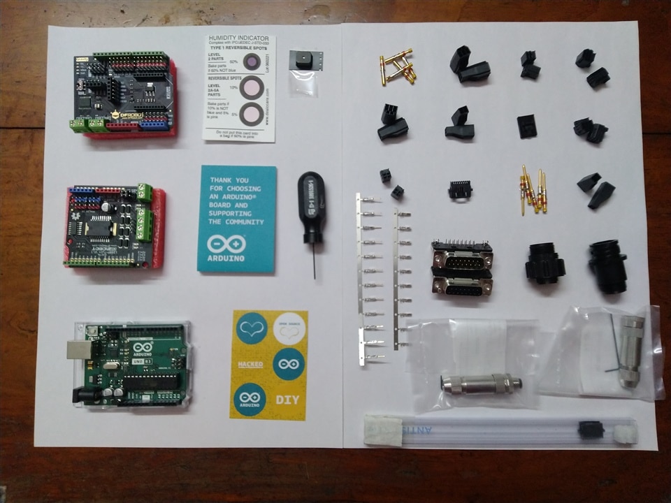

1. The Official Challenger Kit
the_kit
Contents
    - Arduino UNO R3 Board
    - DFRobot 2x2A Motor Shield for Arduino Twin
    - DFRobot Gravity: IO Expansion & Motor Driver Shield
    - TE Connectors (so many, can't even name them all)
I really like the Italy Made Arduino UNO R3 board. I have been working on these cheap Arduino UNO clones for such a long time.

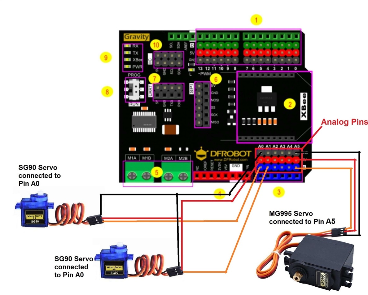

3.2 Connections
Two SG90 servo motor are connected to the pins A0 and A1.
1 MG995 servo motor is connected to pin A5.
The Analog pins on the shield are attached along with 5V and GND pins in the same order as the Servo motors. It made easier for me to directly put the servo motor connectors into the pins.
3.3 Arduino Code
Github Code - gravity_shield_servo_control.ino
3.4 Output
